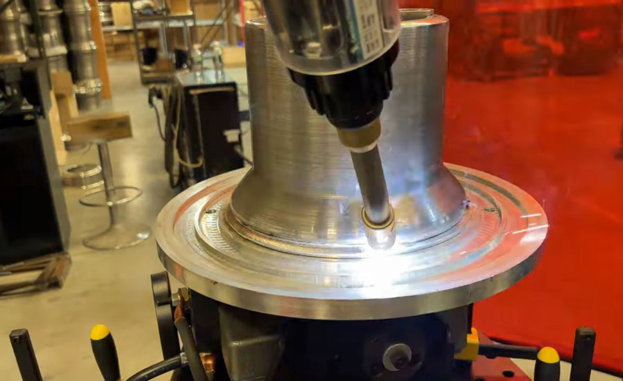

A variety of processes are needed to make racing wheels, including forging, machining and welding.
A variety of processes are needed to make racing wheels, including forging, machining and welding. Photo courtesy Phillips Corp.
Vahlco makes aluminum wheels for race cars, including dragsters and sprint cars. Photo courtesy Phillips Corp.

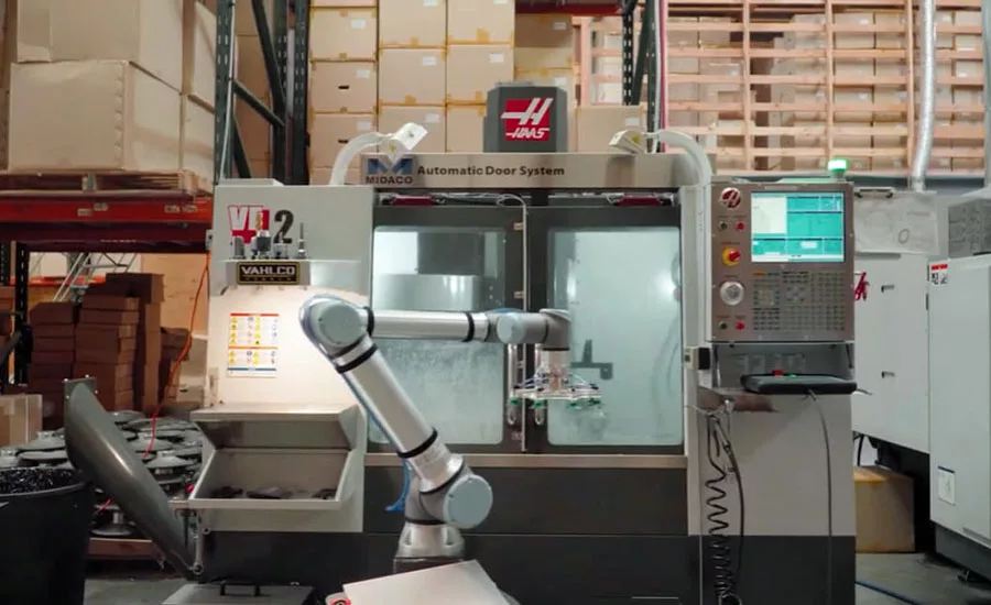

Vahlco was losing valuable time on a repetitive prep operation that tied up skilled labor and limited machine uptime. Operators had to manually tend a Haas CNC machine throughout the day, pulling them away from more complex, higher-value tasks. To stay efficient and competitive, Vahlco needed to automate this process without overhauling the floor layout or increasing staffing.
To solve the problem, Vahlco turned to its machine tool supplier Phillips Corp. Based in Hanover, MD, Phillips has regional offices throughout the Southeast and Mid-Atlantic states. The distributor represents lines such as Haas, Sharp, Markforged, Meltio, Laserline, EOS and Universal Robots (UR).
Within just two days, Phillips application engineers team installed and programmed a UR cobot to load and unload the machine, enabling it to run with minimal supervision. The cobot is mounted in front of the machine; no cages were necessary.
If manufacturers can automate mundane tasks, such as tending machines, they can free up valuable personnel for tasks that do add value. Photo courtesy Phillips Corp.
Vahlco was losing valuable time on a repetitive prep operation that tied up skilled labor and limited machine uptime. Photo courtesy Phillips Corp.
The result was a 50 percent increase in spindle uptime, an 80 percent reduction in operator input, and a projected return on investment in less than 12 months. With the robot keeping the machine fed throughout the day, Vahlco’s team was able to shift focus to higher-value tasks—without slowing down production.
“It was fast. They came in, set it up, and we were running. The robot keeps the machine fed all day,” reports one Vahlco worker. “We load parts two or three times a day. After that, the robot runs it. We’re free to work the rest of the shop.”
After this successful deployment, Vahlco is identifying other prep tasks to automate and exploring lights-out capability for additional machines.
