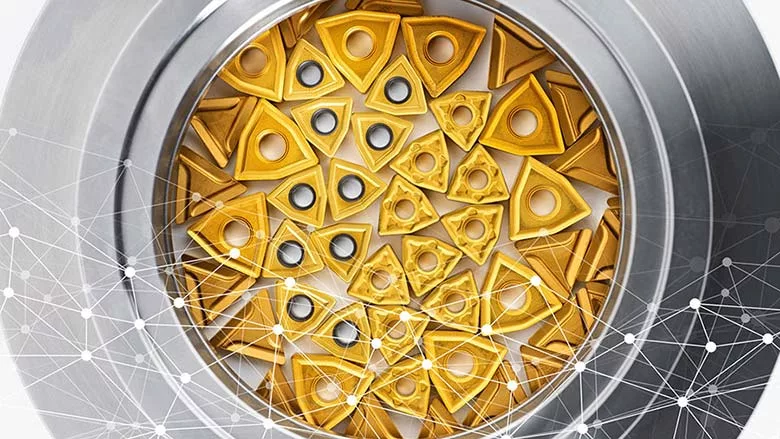

Manufacturing inserts is a high-precision process. Exact geometry and a perfect surface finish are critical. Even minimal deviations can adversely affect the service life and performance of the insert. Defects that are invisible to the human eye can cause immense damage. Careful quality control is essential to ensure that only flawless inserts leave the production process.
This was the challenge presented recently to engineers at Xactools, a manufacturer of automated inspection and measurement systems in Bönnigheim, Germany. Xactools needed to design and build a flexible, high-speed automated inspection system for a Scandinavian manufacturer of indexable inserts.

Flexibility was a major challenge for the project. Inserts come in myriad shapes, sizes and materials to match specific cutting and shaping applications. The insert manufacturer offers some 2,800 inserts in its portfolio, which can be divided into almost 100 geometry families. Xactools needed to automate handling and inspection for all of them.
