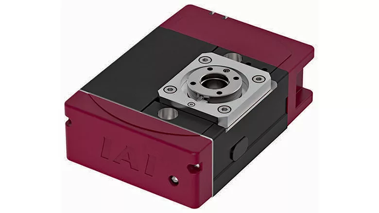

The Elecylinder allows acceleration, velocity and deceleration to be set using numeric values.
Photo courtesy IAI America Inc.

One of the newest electric rotary actuators is the Elecylinder from IAI America Inc. The Elecylinder allows acceleration, velocity and deceleration to be set using numeric values. This enables engineers to adjust the motion of the actuator for smooth stopping without impact.
The actuator is easily programmed with a wireless controller. No cable connection is required. The controller can be operated from a remote location, and it be connected to as many as 16 axes. The wireless controller can be used for basic programming (positions, acceleration, speed and deceleration); reading the current position; performing a test run; jogging the motion of the actuator; releasing the brake; turning the device on and off; displaying cycle time and error messages; and resetting the alarm.
The actuator comes in four sizes. All four provide 330 degrees of rotary motion.
The smallest, Model EC-RTB4, is 45 millimeters wide and 120 millimeters long. By mounting the built-in motor vertically, its footprint has been reduced. A hollow shaft, 12 millimeters in diameter, provides easy routing for wiring and piping. The actuator’s rotation center is located in the center of the main unit for well-balanced mounting. It provides a maximum torque of 0.6 newton-meter.
Model EC-RTC9 is 90 millimeters wide and 133 millimeters long. It provides a maximum torque of 1.5 newton-meters. Model EC-RTC12 is 117 millimeters wide and 166 millimeters long. It provides a maximum torque of 8 newton-meters. Model EC-RTC19 is 185 millimeters wide and 213 millimeters long. It provides a maximum torque of 25.2 newton-meters.
Model EC-RTC12 offers an energy-saving mode. When enabled, it will reduce the device’s power consumption by up to 40 percent. However, this will also reduce the unit’s maximum speed, acceleration, deceleration and payload.
