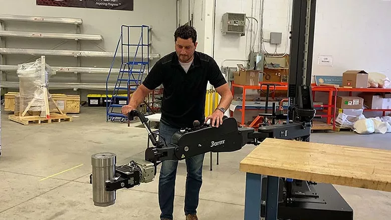

Grippers
Grippers work best on round parts and allow the operator to rotate and position objects even in difficult spots. Photo courtesy 3arm America

The shape, dimensions and weight of your part determine the best end-effector or gripping system. Options include a gripper, vacuum, magnet or custom device.
Grippers work best on round parts and allow the operator to rotate and position objects even in difficult spots. Vacuum end-effectors are ideal for handling flat and nonporous parts. They can pick up a variety of shapes, sizes and types of material. Magnetic end-effectors work best for heavy steel parts and provide a level of safety, since the gripper remains on when the power goes out.
