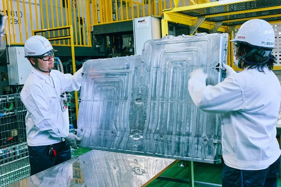

Honda engineers are focusing their efforts on four core production technologies, including megacasting and friction stir welding.
Megacasting involves molding large cast parts such as one-piece battery enclosures that eliminate seams. A new battery case, which traditionally consists of more than 60 parts, has been reduced to only five parts, making it possible to produce a high-quality, thin and light enclosure.
3D Friction Stir Welding (FSW) is being applied to two processes in the manufacturing of battery cases. The first is the process of joining parts made by megacasting to form the case enclosure, and the second is the process of joining the water jacket cover, which is necessary to provide the battery with cooling. The technology uses only the frictional heat between the rotating rod-shaped tool and the joint to soften and join the aluminum parts.
“We believe that FSW is an important way to increase the flexibility and productivity of our products,” says Atsushi Yoshida, a Honda engineer working on the project. “As there is less damage to the base material from heat than with conventional welding, joints can easily be maintained at a high quality, making the entire battery case thinner and lighter while ensuring joint strength and airtightness.
“With battery case manufacturing, we focused on shortening the processes,” explains Yoshida. “By setting the joining conditions according to characteristics such as strength that vary by material and optimizing tool movements and other factors according to the shape of the joints, we were able to stabilize the quality of the joints while minimizing the amount of preprocessing required.”
