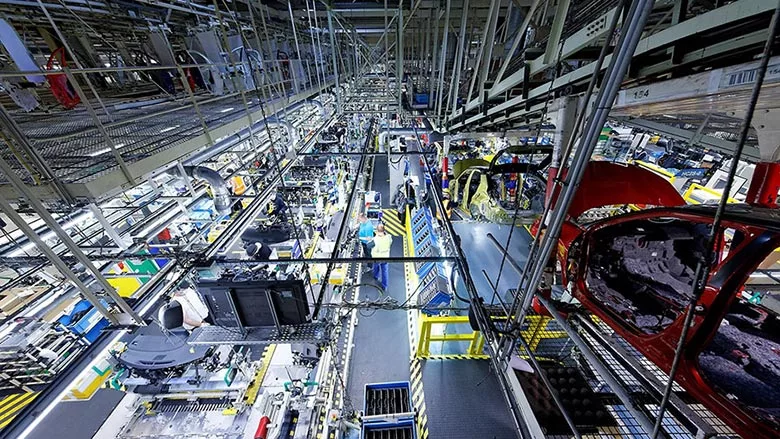

Final Assembly
When it arrives at final assembly, the Yaris is just an empty shell, but it will leave as a finished vehicle, complete with wire harnesses, hoses, brakes, engine, windows, bumpers, wheels, seats, steering wheel, and other components. There are around 3,000 components to assemble on each vehicle. The assembly line is equipped with 1,450 screwdrivers that install 1.4 million screws daily.
Of all the areas in the plant, final assembly employs the most people. Interestingly, 30 percent of the staff in final assembly are women.
automated screwdriving
The assembly line is equipped with 1,450 screwdrivers that install 1.4 million screws daily. Photo courtesy Toyota Motor Corp.
The logistics department receives all the parts for manufacturing, stores them and supplies them to the line in a just-in-time manner. This is TMMF’s largest department. Spanning 40,747 square meters, it’s as large as six soccer pitches. Some 250 trucks pass through its 28 unloading docks daily.
Parts come from 200 suppliers and are delivered in standardized blue plastic boxes, which travel back and forth between suppliers and the plant. This eliminates the need for cardboard boxes and wooden pallets. The logistics prep area has a reserve of parts for less than two hours of production. All totaled, the plant receives some 3.8 million parts daily.
At the end of the line, inspection teams perform various static checks and dynamic performance tests. Each vehicle is checked throughout each manufacturing stage. The process includes 2,500 inspection points.
