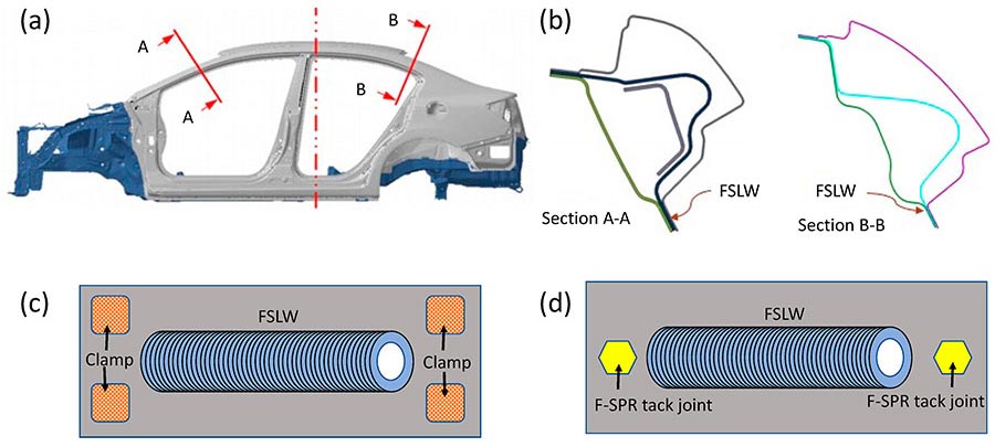

body-in-white design
Illustration A shows an aluminum-intensive body-in-white design. Illustration B shows examples of the complex shapes involved of body-in-white structures, along with the location of joints assembled with friction stir welding. Illustration C shows clamping strategies for a flat bead on metal sheets using friction stir welding. Illustration D shows a new approach using spot joints produced by friction SPR. This promises to reduce complex clamping design and excessive clamping force prior to friction stir welding. Source: Soochow University

Clamping is critical for friction stir welding. High force and complex fixtures are needed to securely hold the parts in place. This can be a challenge when assembling automotive parts with complex shapes and contours. Friction SPR addresses this issue by functioning as a spot-joining technique, effectively securing the body parts before a linear weld is accomplished. An added benefit of friction SPR lies in its ability to contribute supplementary mechanical joint strength alongside a linear weld.

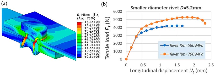

performance modeling of a riveted joint with a shank diameter of 5.2 millimeters
This illustration shows performance modeling of a riveted joint with a shank diameter of 5.2 millimeters. Source: Soochow University

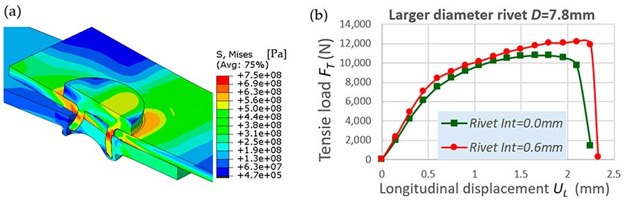

performance modeling of riveted joint with a shank diameter of 7.8 millimeters
This illustration shows performance modeling of riveted joint with a shank diameter of 7.8 millimeters. Source: Soochow University

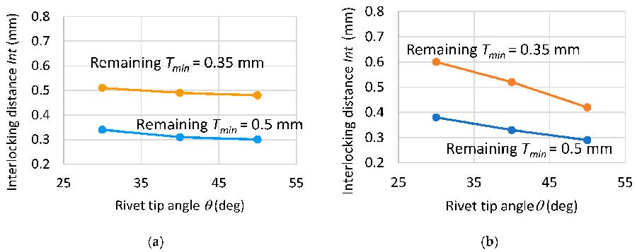

Rivet Tip Angle and Die Cavity Depth
The geometry of the rivet and die has a decisive effect on both joint formation and performance. More specifically, the rivet tip angle, as well as the die cavity depth, should be designed to match the sheet stack-up and material properties.
Mechanical interlocking is a function of the remaining thickness of any given rivet or tool geometry. The reason for using the remaining thickness as an indicator is that plunging depth can be a variable of sheet thickness and rivet length. Three tip angles—30, 40 and 50 degrees—were studied numerically. In addition, two cavity depths, 1 millimeter and 1.5 millimeter, were examined under two thickness cases, 0.35 millimeter and 0.5 millimeter.
We found that, under the same remaining thickness, a rivet with a 30-degree tip angle provides greater mechanical interlocking than a rivet with a 50-degree tip angle. By reducing the remaining thickness from 0.5 millimeter to 0.35 millimeter, the interlocking distance can be further increased by 60 percent. By using a shallower die (cavity depth of 1 millimeter), the interlocking performance becomes slightly better at the cost of greater plunging force. Under the same remaining thickness, a shallower die cavity tends to make the rivet leg thicker because of significant hydrostatic pressure.
A smaller remaining thickness, 0.35 millimeter, resulted in a doubled interlocking distance compared with a remaining thickness of 0.5 millimeter, which indicates that the rivet length and plunging depth can be refined to achieve the best performance of the rivet. On the other hand, a sharper rivet angle leads to increased mechanical interlocking with a shallower die. It can also be concluded that the rivet-interlocking behavior is less sensitive to rivet tip angle with a die cavity depth of 1.5 millimeters.

Load-carrying capacity depends on the interlocking distance as well as the rivet cross-sectional area, which is a function of the rivet shank diameter and wall thickness. In addition, the rivet material strength plays a critical role in governing the joint strength.
For a given interlocking distance, a performance model can be employed to conduct a sensitivity study on the rivet shank diameter, as well as its material strength. Two rivet diameters were numerically studied: 5.2 and 7.8 millimeters. Wall thickness was kept the same for both. The tensile strengths of the rivets were 560 and 780 MPa. Only half the model was considered, given the symmetry in evaluating the joint shear strength.
When the rivet shank diameter is 5.2 millimeters, the peak load is below 6 kilonewtons (kN) because a small effective joint area sustains the shear load. The rivet fractures at the cross-section near the joint interface between the aluminum sheets.
When the rivet shank diameter is increased to 7.8 millimeters, the peak load is above 10 kN. The joint exhibited a button-pull-out failure mode rather than a rivet failure. It is interesting to note that the joint without an interlocking distance also delivered a shear load just 2 kN less than the joint with an interlocking distance of 0.6 millimeter. This is because the shear load direction is normal to the rivet axial direction, and the effective load-bearing area is more than 45 square millimeters.
Based on this analysis, the rivet was designed with a larger diameter of 7.2 millimeter, a tip angle of 30, and a die cavity depth of 1.2 millimeter.

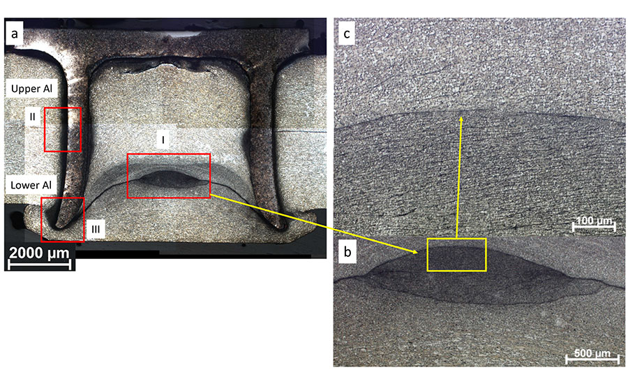

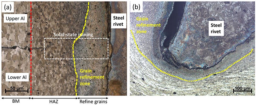

cross-sections of aluminum sheets riveted with the friction SPR process
This optical macrograph shows cross-sections of aluminum sheets riveted with the friction SPR process. Images B and C show solid-state joining between the upper and lower sheets. Source: Soochow University
SPR testing
This magnified optical image (a) of the joint interface on the left side shows solid-state joining between the upper and lower aluminum sheets and a grain refinement area marked in zone II. The magnified optical image (b) of the rivet tip region on the left side of the joint shows refined grain. Source: Soochow University
The overall rivet flaring and aluminum sheet bottom finishing are satisfactory, although there is a slight lack of material fill inside the rivet, which indicates the plunging depth can be further increased. This is also evidenced by the large remaining thickness, which is about 0.75 millimeter. On the other hand, the rivet head seems to have redundant material, which will increase the weight of the friction SPR joint. The rivet has a sharp tip for penetrating material, and thus, mechanical interlocking is greatly increased, which is promising for achieving higher lap-shear strength and cross-tension capacity loads.

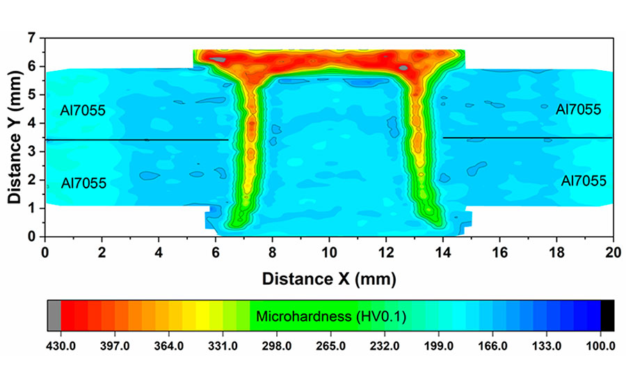

Vickers microhardness mapping of the refined riveted joint
This images shows Vickers microhardness mapping of the refined riveted joint. Source: Soochow University

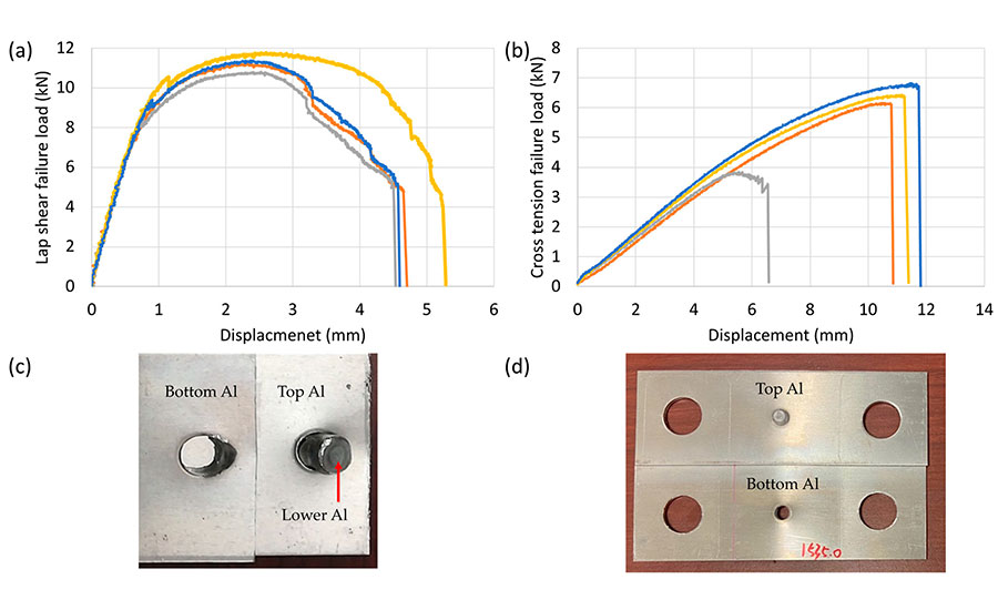

lap-shear tensile tests and cross-tension tests on four samples
The researchers conducted lap-shear tensile tests and cross-tension tests on four samples. Our joints achieved an average peak failure load of 11.3 ± 0.35 kN. The failure mode of all four coupons was the bottom sheet pulling out at the joint, indicating good mechanical interlocking and solid-state joining between the aluminum sheets and between the aluminum and the rivet. Source: Soochow University

In the assembled joints, the measured mechanical interlocking distance is around 0.46 millimeter, which is similar to the predicted value in our numerical model. In addition, it can be observed that the remaining thickness in the joint is 0.4 millimeter, reduced from 0.75 millimeter in the initial case.
Looking at the joint, a continuous material flow line between the upper and lower aluminum sheets is seen because of an interaction with the rivet during the joining process. Also, solid-state joining can be observed because of the combined effects of frictional heat and compressive axial load from the joining process.
Magnified optical images of the joint show grain refinement of the aluminum where it is very close to the steel rivet. This is due to dynamic recrystallization caused by frictional and severe plastic deformations. Also, approximately 150 microns of solid-state joining area between the upper and lower aluminum sheets were found.
We conducted lap-shear tensile tests and cross-tension tests on four samples. Our joints achieved an average peak failure load of 11.3 ± 0.35 kN. The failure mode of all four coupons was the bottom sheet pulling out at the joint, indicating good mechanical interlocking and solid-state joining between the aluminum sheets and between the aluminum and the rivet. This is evidenced by the grain refinement and material flow of aluminum near the rivet joint.
Cross-tension strength averaged to be 5.82 ± 1.35 kN, and three out of four samples exhibited failure at the bottom aluminum sheet.
