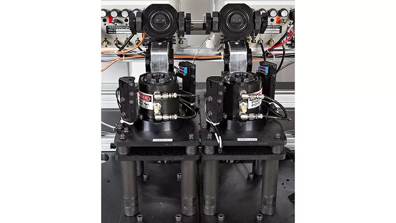

leak testing
These test fixtures are used for fuel-related components.

fuel injector test stand
This fuel injector test stand can handle more than 350 parts per hour. Photo courtesy InterTech Development Co.

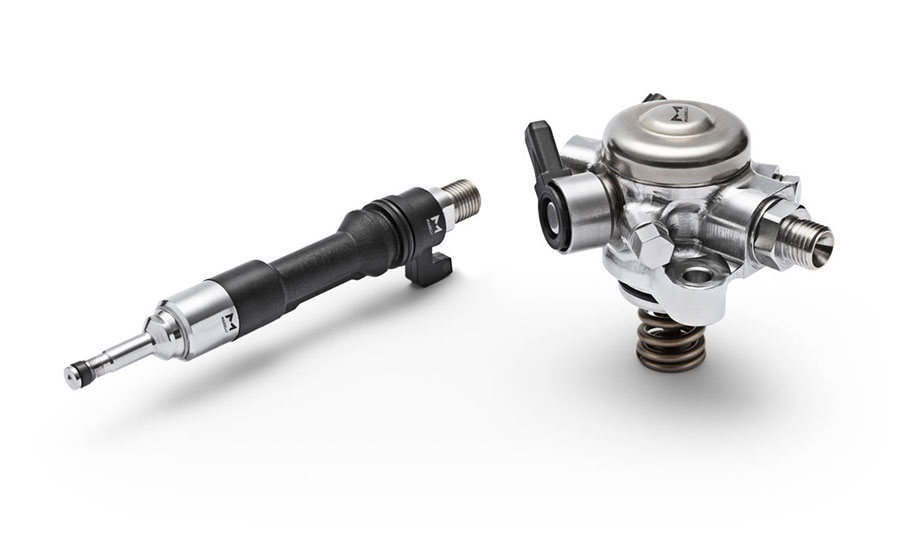

high-pressure fuel system
High-pressure fuel systems need to be tested for leaks to prevent safety risks and loss of engine power. Photo courtesy Marelli

Gasoline direct injection (GDI) systems offer improved fuel economy, lower emissions and enhanced engine performance, making them a preferred choice among automakers aiming to meet stringent environmental regulations.
Whether it’s a compact sedan or a pickup truck, GDI technology injects fuel into engine cylinders, where fuel is burned to produce power. A leaky fuel injector, which is a common fuel injection system problem, can significantly compromise engine performance and produce a variety of symptoms.
In a worst case scenario, an excessive fuel leak onto the hot surfaces of an engine intake manifold or engine block can cause the fuel to ignite and create a fire.
“Fuel injection components often demand 100 percent leak testing to limits as low as 0.01 sccm with cycles as fast as 2.5 seconds, while also displaying significant part temperature variations,” says Hoffmann. “Fuel injectors have been around a long time, but the designs have evolved so that they can operate at higher pressures and tighter tolerances. We see applications up to 100 bar and 3,000 psi.”
InterTech’s downstream test process features a patented mass-flow transducer to provide 10 times greater leak sensitivity than any other dry-air test method. A test part is enclosed within a test chamber and pressurized. Leakage is measured as a flow increase into the test circuit outside the part, eliminating the need and time for pressure stabilization inside the part.
“The test circuit is precisely engineered for minimum volume, enabling the sensor to almost instantaneously measure flows with a resolution of 0.0001 sccm,” explains Hoffmann.
“Critical for fast small-leak testing, all fixtures and clamping devices are designed and built for absolute stability to prevent part movement during testing,” claims Hoffmann. “Seal positioning mechanisms consistently address the test part squarely and firmly, stabilizing their closure forces quickly to shorten cycle times.
“Seals are designed for high durability to run thousands of parts per day without replacement,” says Hoffmann. “With these unique features, micro flow dry-air test systems deliver 0.01 sccm testing with less than 10 percent R&R.”
