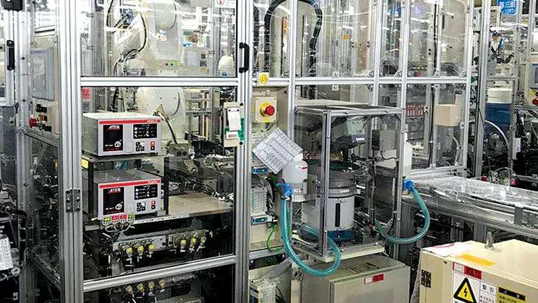

“The most common problem engineers encounter is not getting the leak testing system they hoped for, thinking that many things were implied, while they needed to be written down,” adds Anne-Marie Dewailly, technical director at ATEQ Corp. “We are experiencing a lot more problems with people who have no leak test experience not knowing what to specify.

“The most important criteria necessary for specifying a leak test system is identifying the reject leak rate and test pressure,” claims Splete. “Those are the first two questions we ask when a customer calls us to help identify the technology and methods for a specific leak test system. “The best way to specify a system is to understand the physics related to what shouldn’t leak into or out of the part,” says Splete. “Then, correlate that to a specified leak rate (volumetric flow over time) with a test pressure. The goal is to choose the best technology that accommodates three things:
  1. Repeatably measuring the leak.
  2. Meeting production throughput, remembering that test cycle times vary based on technology and part types.
  3. Helping accommodate budgets with manual sealing devices or automated test systems.”
