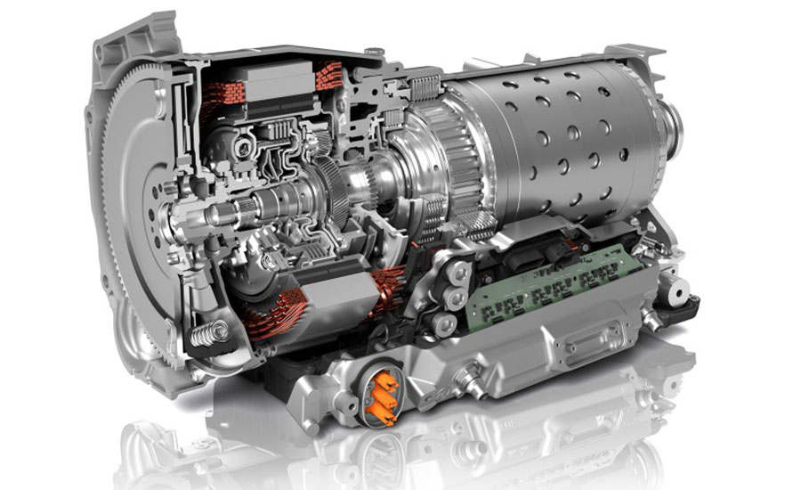

e-drive
This e-drive is used to power hybrid versions of Porsche sports cars. Photo courtesy Porsche AG

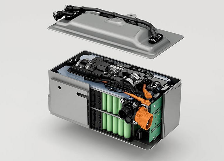

e-drive
Batteries are an important component in hybrid vehicles. Photo courtesy Porsche AG
However, Boutell believes that the most impactful decision was the redesign of the hybrid battery.
“By increasing the contact area between the electrode and electrolyte, and shortening the distance between electrodes, we have achieved a 16 percent improvement in power density,” he explains.
Together, these upgrades have led to system-wide benefits, including a 1.6 times increase in system power from 90 kilowatts (kW) to 146 kW, which gives the vehicle an acceleration experience like a BEV.
The new system also delivers a 10 percent fuel economy improvement, boosting mileage from 49 mpg to 54 mpg on all-wheel drive (AWD) Prius models. Meanwhile, optional rear-motor AWD provides better handling in dry conditions and improved traction on ice, while acceleration feels more responsive and linear, enhancing the driving experience across varied conditions.

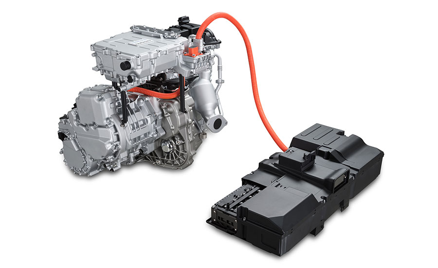

Nissan’s e-Power system
Nissan’s proprietary e-Power system provides an EV-like experience without full battery reliance. Photo courtesy Nissan Motor Co.
A New Direction in Hybrid Technology
Nissan Motor Co.’s development of hybrid technology represents another approach, particularly with its proprietary e-Power system, which offers an EV-like experience without full battery reliance. Unlike traditional hybrids, which combine electric and combustion engines, it only uses the gasoline engine to generate electricity.
This design is made possible by integrating a high-voltage battery with a power train that includes a high-power motor, an inverter, a gasoline engine and a generator. Nissan views it as a bridge between ICE vehicles and full EVs.
“E-Power is born from EV experience, where most hybrids are [evolved] from an evolution of an internal combustion engine,” says David Moss, regional senior vice president of research and development at Nissan. “It’s about capturing the modern driving feel of an EV, but for customers not ready to fully transition to electric.”
This EV-inspired driving experience was shaped by consumer feedback on the elements of EVs they appreciate most—quietness, smoothness and instantaneous acceleration.
Wheels are driven entirely by an electric motor, while a small onboard gasoline engine powers a generator that produces electricity. It maintains a stable, quiet operation since its speed is independent of the car’s movement, allowing for a more linear, EV-like experience.
By decoupling the engine from the drivetrain, Moss says the system can optimize the start timing and maintain the engine at its most efficient rpm.
“We wanted to create a seamless drive where the engine and electric power interact smoothly, eliminating the noise and gear changes of traditional hybrids,” explains Moss. “It’s about harmony and consistency in the drive.”

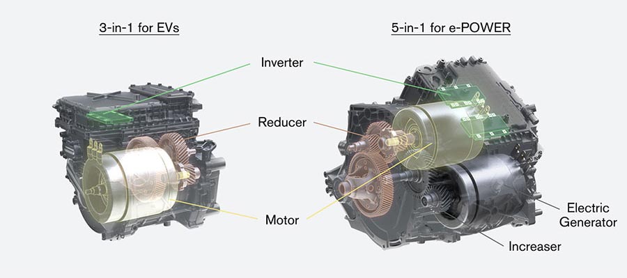

Nissan’s X-in-1 systems
Nissan’s X-in-1 systems modularizes five drivetrain components. Photo courtesy Nissan Motor Co.
Beyond Design
Nissan’s Moss believes that hybrid technology goes beyond design. In fact, it significantly influences the assembly and production process, thanks to advancements in modularization. The automaker recently initiated an assembly process called the “X-in-1” approach, where components are consolidated to streamline production, improve efficiency and reduce costs.
According to Moss, X-in-1 will result in improved performance, reduced weight, smaller size, and better noise and vibration control through integration. Additionally, sharing core components will lead to cost reductions.
“The idea was to modularize core components into one unit to simplify the assembly process,” says Moss. “We achieved a system where, for instance, in e-Power, we combine five components into a single unit.”
