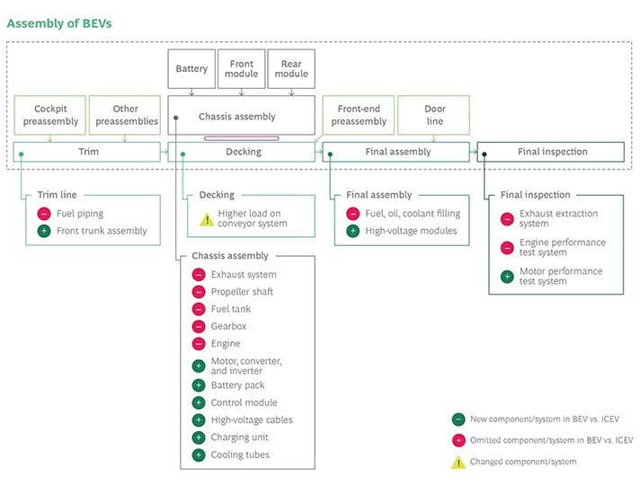

differences between assembling gas- and battery-powered vehicles
There are key differences between assembling gas- and battery-powered vehicles, such as a unique set of components. Illustration courtesy Boston Consulting Group
