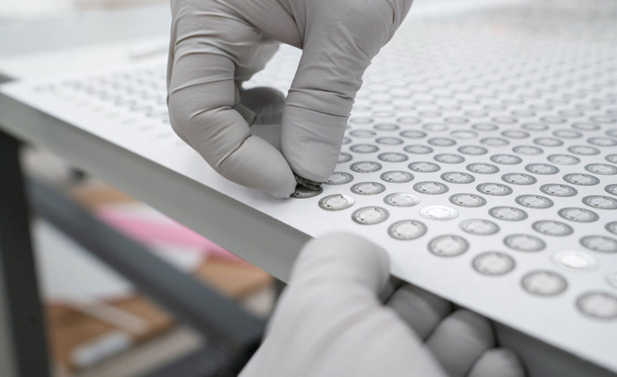

Operators return and move the sheet of disks to a worktable. In a manual process called “disk picking,” they pick the adhered disks from the sheet and stack them on a rod for storage in inventory.

For years, disk picking had been an occasional minor task for the operators. It was something they could easily fit in during their busy workday, and it didn’t take much time—until a new product disrupted the status quo.

picking the E4T encoder disks by hand
Because of the decreased size of E4T encoder disks, picking them by hand was time-consuming—especially since there are more than 1,000 disks on a sheet. Photo courtesy US Digital

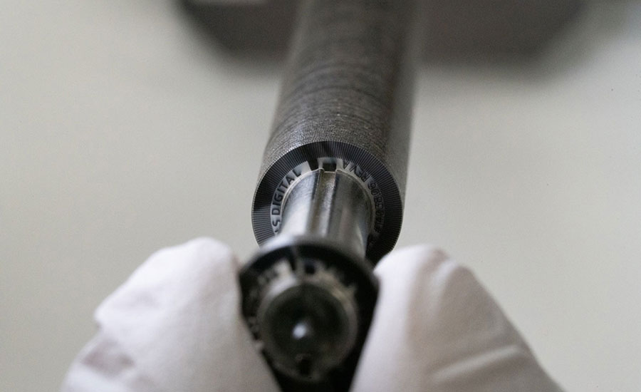

Stacking Rods
After picking up a disk, the robot moves at full speed to the edge of the table, where it stops and hovers above a vertical stacking rod.
The vacuum turns off, and to help the disk on its way, a jet of compressed air blasts the disk off the tool and down the rod.
E4T encoder disks have tabs that fit into grooves on the hub
The disks have tabs that fit into grooves on the hub, ensuring that each disk is held securely. Photo courtesy US Digital
Viestenz designed a series of stacking rods for the various sizes of disk that are processed on the machine. For the rods used with E4T disks—the ones with the two tabs protruding into their internal diameter—he created matching grooves in the rods to accept the tabs. The robot precisely aligns the disk above the rod, so that the tabs line up perfectly with the grooves when the disk is discharged from the tool.
To allow for tolerances while discharging the disks, Viestenz designed a removable, tapered tip to fit on the end of the rod. This creates relief to account for position errors of up to 0.02 inch as the robot moves into position.
