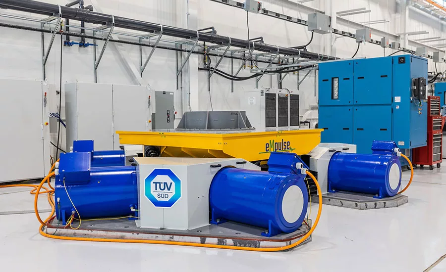

multi-axis shaker table
This multi-axis shaker table simulates real-world vibrations.
Photo courtesy TÜV SÜD America Inc.

The facility is equipped to handle batteries up to 1,200 volts. It boasts an electrodynamic vibration table capable of generating forces up to 350 kilonewton, as well as an electrodynamic MAST (multi-axis shaker table) system for six degrees of freedom testing and high-frequency response. Another device can crush EV batteries with forces of up to 1 meganewton.
