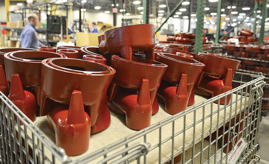

Cast-iron pump housings can weigh 50 to 70 pounds. A finished pump can weigh 300 pounds or more. Photo courtesy Liberty Pumps

Pumps for handling ground water and waste water are not light. Made of cast iron, a 5-hp sewage pump can weigh 300 pounds. Handling heavy parts and assemblies represents a significant safety and ergonomics challenge. Over the years, Liberty Pumps has come to Gorbel Inc. for help with material handling.
