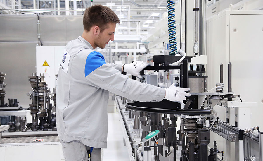

inspecting transmission components
Gears and other transmission components are machined to strict tolerances. Photo courtesy Volkswagen

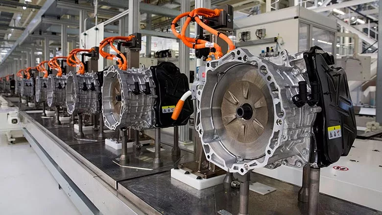

assembling transmissions
VW’s assembly plant in Kassel, Germany, produces 3 million transmissions and electric drives annually. Photo courtesy Volkswagen

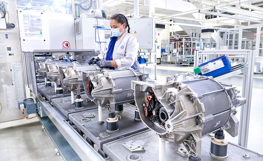

transmission undergoes function testing
A transmission undergoes function testing at the end of the assembly line. Photo courtesy Volkswagen
