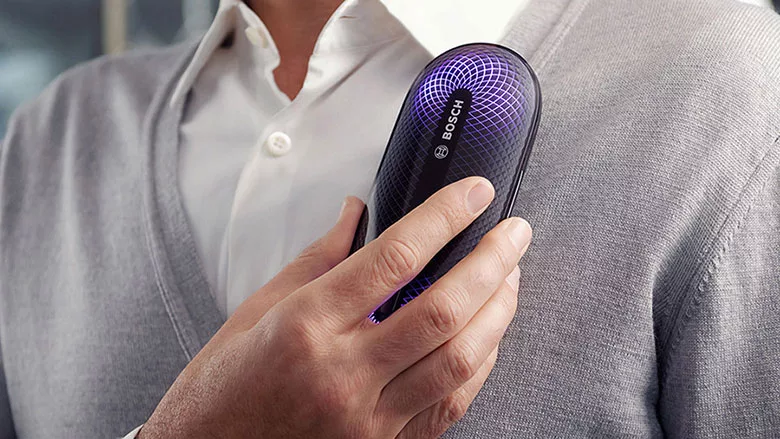

Although we may not want to admit it, most of us have a “chairdrobe.” When worn clothes are too clean to wash, but are no longer fresh enough to put back into the closet, we drape them over a chair to be donned on a later date.
Engineers at Bosch Home Appliances have come up with a clever new gadget that promises to help us with the chairdrobe problem. The FreshUp is a handheld, battery-powered device that uses plasma to remove unpleasant odors, bacteria and viruses from dry clothes without the need to wash them. When the plasma source is activated, the air is ionized directly at the fabric. Molecular chains are broken, and bacteria and viruses are destroyed. This permanently neutralizes odors without the use of chemicals.
The gadget is great for getting extra mileage out of clothing that’s clean, but might have absorbed unpleasant smells, such cigarette smoke, body odor and food smells. It’s also helpful for travelers, who might not have access to a washer and dryer.
FreshUp device
The plasma is powerful enough to dissolve odor-causing molecules, but not so powerful that it destroys textile fibers. Photo courtesy Bosch Home Appliances
The plasma is powerful enough to dissolve odor-causing molecules, but not so powerful that it destroys strong or complex structures, such as textile fibers. The device removes odors from cotton, silk, cashmere, wool, linen, and polyester blends. It can be used on both sportswear and functional clothes. It can even be used on cushions or teddy bears. And, it can be safely used on clothes while they are being worn.
The device cannot be used on leather, fur, metal fibers, foam or any other non-textile surface, including skin, hair or animals.
FreshUp is a lozenge-shaped device measuring 6.5 inches long, with a 2-inch treatment area on its underside.
