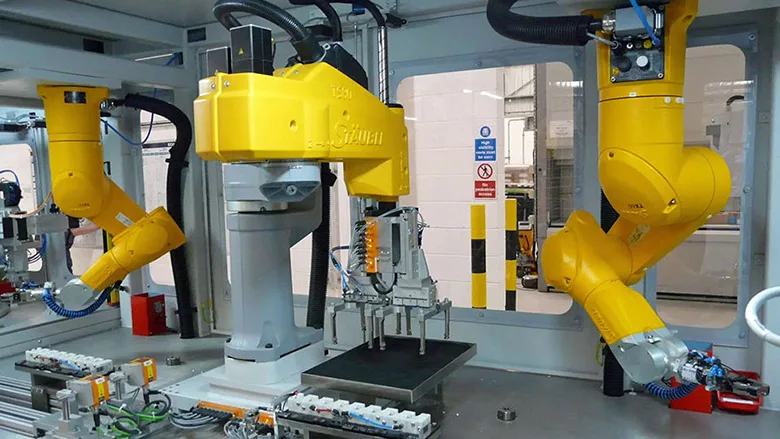

robots automate assembly of air bag sensors
Both SCARA and six-axis robots automate assembly of air bag sensors. Photo courtesy Stäubli

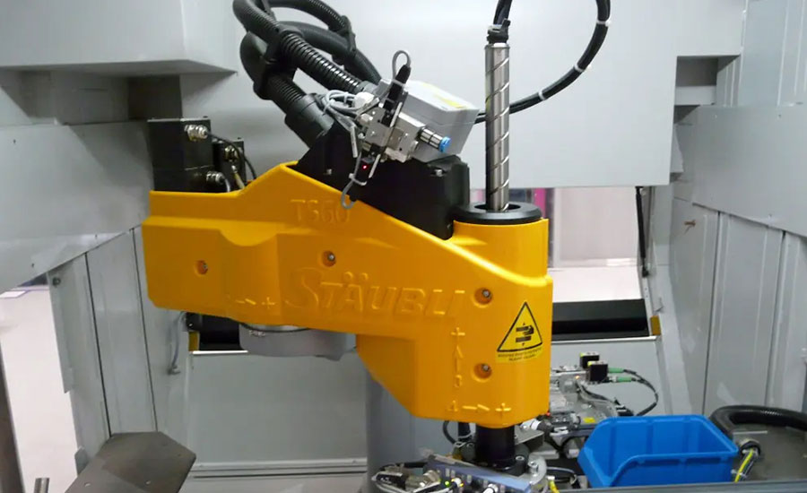

SCARA robot
This SCARA robot has a 620-millimeter reach and can carry a maximum payload of 8.4 kilograms. Photo courtesy Stäubli

To design and build the line, ZF brought in German system integrators Grohmann Engineering and IPTE Factory Automation. A preliminary analysis revealed that simply expanding or duplicating the existing manual assembly line would not be able to compete with a fully automated line in terms of either output or cost benefit. As a result, ZF opted for a new, fully automated assembly line based on four-axis and six-axis robots supplied by Stäubli Robotics.
The new assembly line consists of several cells connected in series, all of which are equipped with Stäubli robots. In the first step, two Stäubli TS60 SCARAs insert a metal contact into a printed circuit board. This is followed by the soldering of electrical contacts on the board. During the subsequent quality inspection, another SCARA TS60 manipulates the components.
The next stage is the over-molding of the PCB. This is carried out by two six-axis RX160 robots, which were chosen for their range and dynamics.

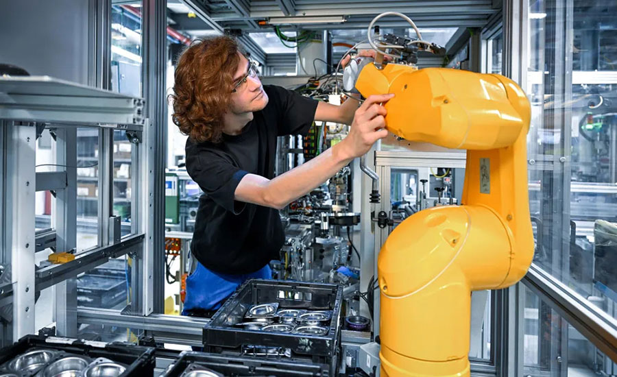

six-axis robot
ZF employs Stäubli robots throughout its worldwide network of assembly plants. This six-axis robot assembles air bags at a factory in Germany. Photo courtesy ZF Friedrichshafen AG

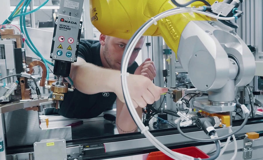

assembler working with Stäubli robot
ZF engineers and assemblers quickly got up to speed on managing the new line, which was running 24 hours a day, six days a week, within its first seven months. Photo courtesy ZF Friedrichshafen AG
