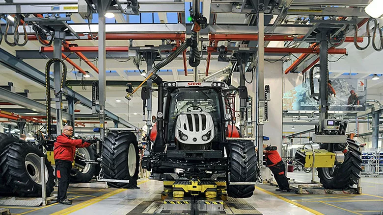

CNH assembly plant in St. Valentin, Austria
The CNH assembly plant in St. Valentin, Austria, produces a new tractor every 10 minutes.

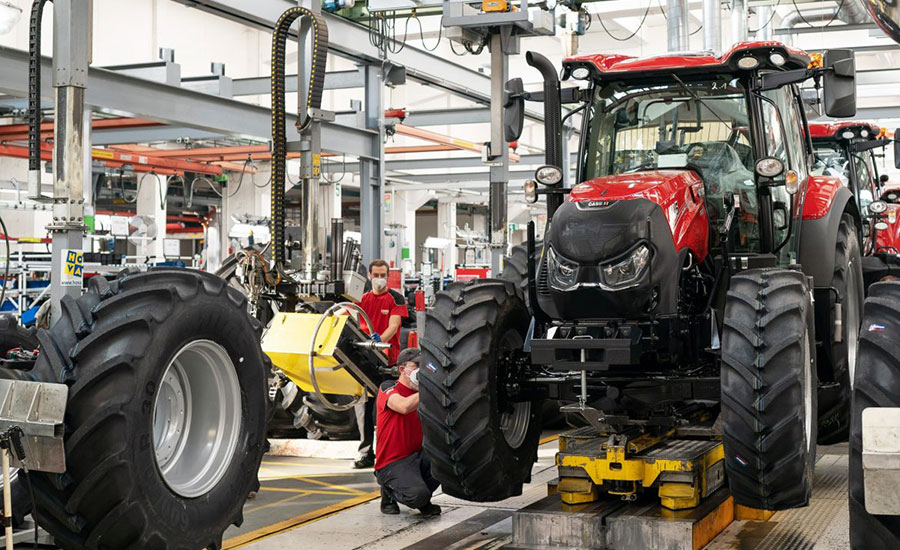

tractor assembly
Each tractor contains thousands of threaded fasteners. Photo courtesy CNH Industrial
