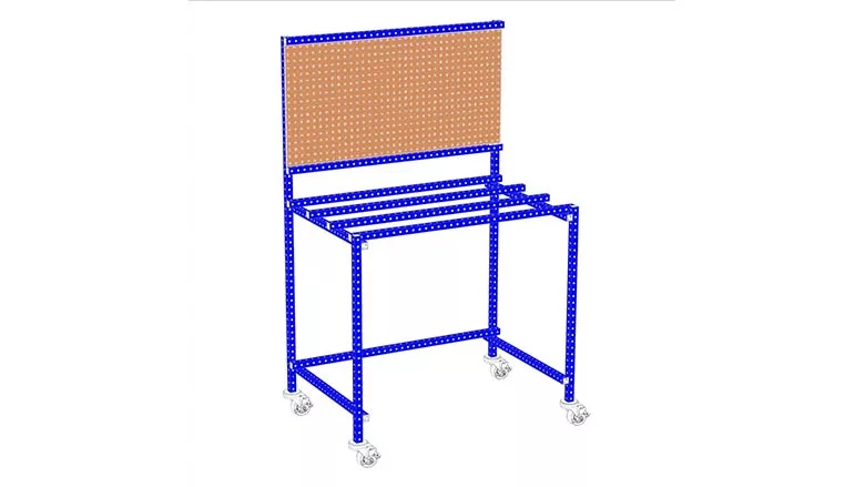

custom, mobile workstation
With Flex Craft’s Assembly Workstation Kit, engineers can build a custom, mobile workstation up to 36 inches long, 24 inches wide, and 58 inches tall.
Photo courtesy Flex Craft

For example, with Flex Craft’s Assembly Workstation Kit, engineers can build a custom, mobile workstation up to 36 inches long, 24 inches wide, and 58 inches tall. The workstation gives assemblers ready access all tools and products necessary to complete the process. Workstations can be color-coded to designate specific departments throughout a factory.
