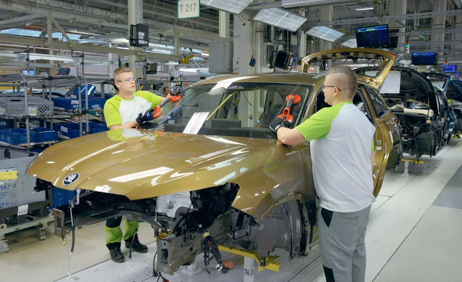

While this technology has made the roads safer, it has made assembly more complex. Assembly processes that were once relatively mundane, such as windshield installation, now require more effort and precision.
The Evolution of Windshield Assembly
Traditionally, windshield installation was a straightforward process focused on structural integrity and weatherproofing, although there have been times when an antenna was integrated. Today, the process is far more complex.
Modern windshields frequently house forward-facing cameras, rain and light sensors, and perhaps even head-up display projectors. These integrated technologies require the glass to meet strict optical standards, since even minor distortions can affect sensor performance and, by extension, vehicle safety.
The windshield’s role has expanded from a passive safety device to an active participant in advanced safety systems. This evolution means that assembly teams must treat the windshield as both a structural and a technological component, ensuring that every installation meets exacting specifications.
Each sensor requires precise placement and alignment to function correctly. For example, a forward-facing camera must be mounted at a specific angle and height to interpret lane markings accurately and detect obstacles.
The integration of ADAS sensors into the windshield assembly process introduces new challenges. Sensors and cameras must be mounted with millimeter-level accuracy. Specialized mounting brackets and adhesives, often developed in partnership with OEMs, ensure each sensor is positioned exactly as designed. Even a slight deviation can result in system malfunctions or false alerts.
Windshields are now made from advanced materials that balance strength, optical clarity, and weight to support these technologies. Miniaturized sensors and modular mounting systems help streamline the assembly process and require careful handling to avoid damage or misalignment.
Sensors must be protected from vibration, moisture and temperature fluctuations. Assembly teams use specific techniques and materials to shield sensitive electronics, ensuring long-term reliability.
