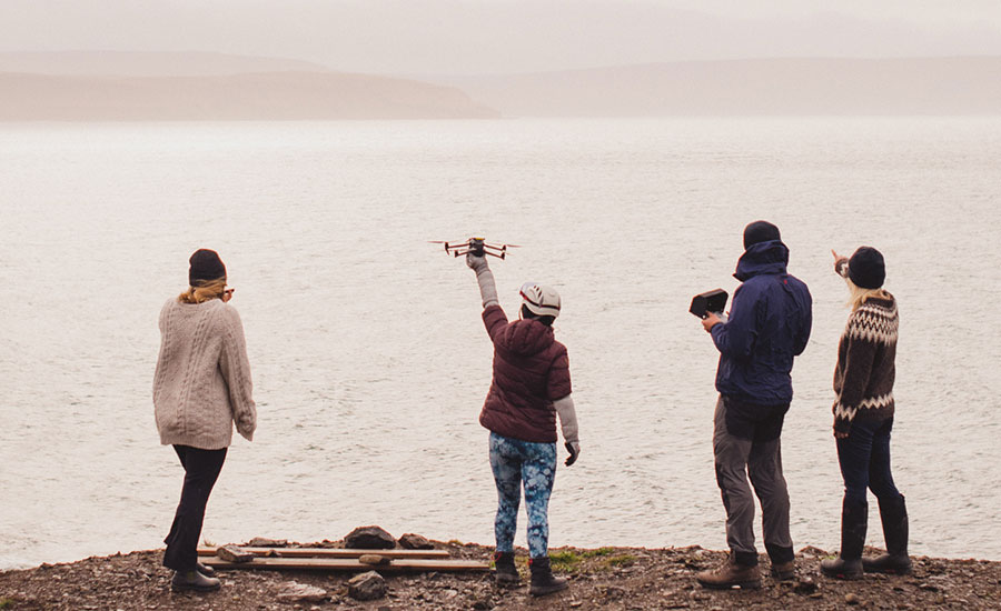

To determine whether whales have had run-ins with fishing nets—and what affect such entanglements might have had on them—Whale Wise volunteers needed a way to examine whales for scarring and to measure their growth. For that, they jury-rigged a lidar apparatus and secured it to an off-the-shelf drone with tape. When whales are spotted off the coast of the UK or Iceland, volunteers fly the drone from shore to measure and photograph the whale.
Their setup worked, but it had some issues. For starters, it was heavy, which shortened the flight time of the drone. It was also bulky, which made it difficult for the drone to land safely on the ground without tipping over. Instead, volunteers had to catch the drone by hand, risking injury. Worst of all, the apparatus was not entirely dependable. Sometimes, volunteers would fly the drone only to discover later that it had not recorded any data.

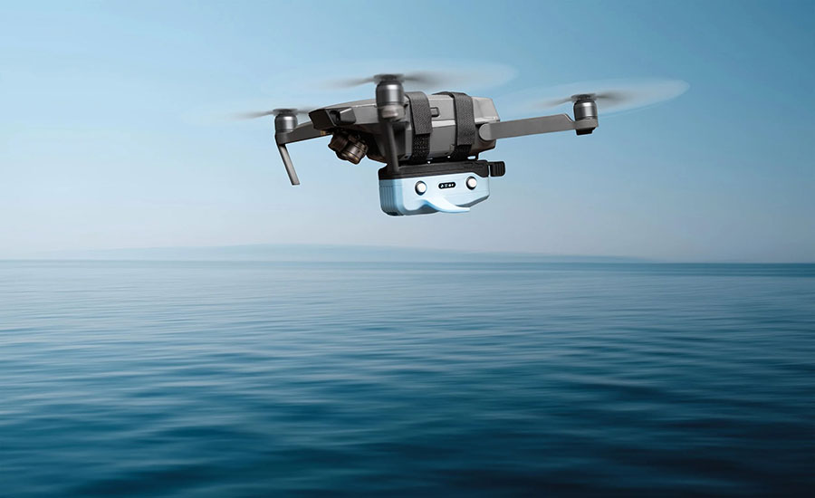

WHASER lidar and camera module attached to the base of a drone
Tandem Ventures designed, prototyped and produced WHASER, a compact, lightweight lidar and camera module that attaches easily to the base of a drone. Photo courtesy Tandem Ventures Ltd.
The WHASER System
With the help of Mouser Electronics, a global distributor of electronic components, Tandem Ventures designed, prototyped and produced WHASER, a compact, lightweight lidar and camera module that attaches easily to the base of a drone without impairing its ability to land. The open-source lidar technology and cameras precisely measure the height of the drone from the surface of the water. From that data, volunteers can gauge the size and weight of the whale. They can even identify specific individuals.

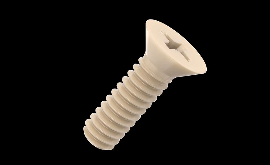

High-performance PEEK bolt
Made of PEEK, this bolt is six times lighter than an equivalent fastener made from stainless steel. Photo courtesy Accu Ltd. Co.

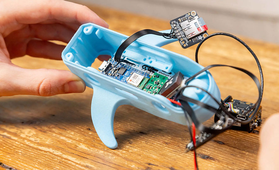

To maximize the drone’s time in the air, it was essential to make the lidar payload as light as possible. For that, Tandem Ventures got help from Accu Ltd. Co. in Huddersfield, UK, 30 miles east of Manchester. Accu manufactures threaded fasteners, rivets, pins, retaining rings and other assembly hardware.

  • High-performance PEEK bolts. A crucial design upgrade involved replacing a traditional heavy stainless steel bolt with a PEEK alternative, which was six times lighter. This weight reduction directly contributed to increased drone flight times and enhanced operational efficiency.

WHASER lightweight lidar and camera module
To maximize the drone’s time in the air, it was essential to make the lidar payload as light as possible. Photo courtesy Mouser Electronics
