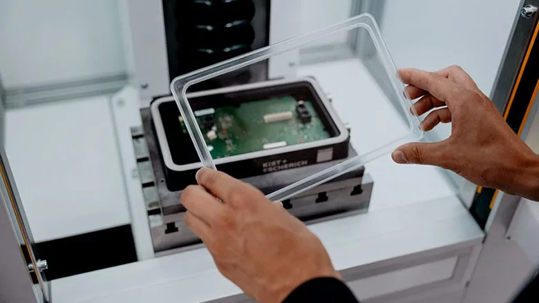

attaching a plastic cover to a metal housing
Photo courtesy Kist + Escherich
The HyJoin process is used to attach this plastic cover to a metal housing. Screws or gaskets are not needed.

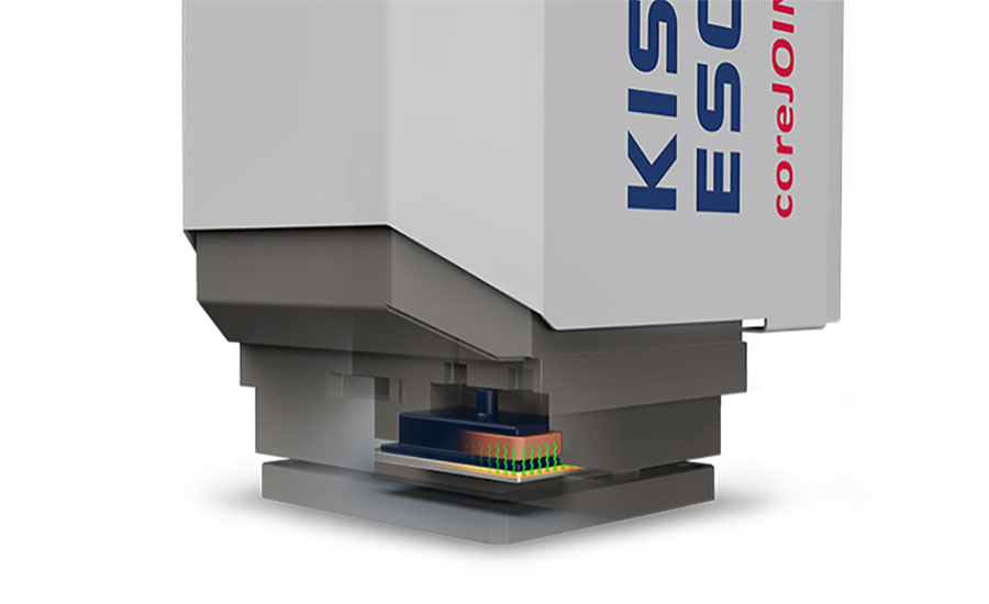

To start the HyJoin process, the metal part is selectively heated in the joining area through electromagnetic induction. Embedded in the upper joining die, the inductive coil is energized by a high-frequency alternating current. Simulations and laboratory tests are used to optimize the design of the coil.
Subsequently or simultaneously during heating, the plastic part is pressed together with the metal part. The plastic reaches the glass transition temperature and melts at the contact area, flowing into microscopic nooks and crevices created in the metal part by the ablative pretreatment. After cooling, the plastic solidifies and becomes mechanically interlocked with the metal part.

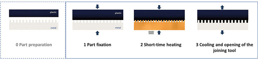

HyJoin process
Prior to assembly, the surface of the metal part must be roughened. To start, the metal part is selectively heated through electromagnetic induction. Next, the plastic part is pressed together with the metal part. The plastic melts at the contact area, flowing into microscopic crevices in the metal part. After cooling, the plastic solidifies and becomes mechanically interlocked with the metal part. Photo courtesy Kist + Escherich

Another application is actively cooled plastic housings for energy storage, sensors or electronics. In this application, the HyJoin process is used to join a metallic heat sink with a plastic part. This obviates the need for screws or gaskets in the assembly. It also lets engineers reduce the width of the joining flange and therefore make the design more compact. At the end of the product’s life cycle, the connection can be thermally separated for recycling.

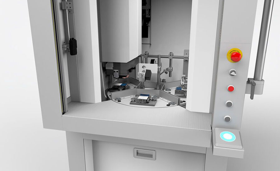

GiroJoin automated assembly cell
GiroJoin is a preconfigured automated assembly cell equipped with a rotary indexing table. Parts can be loaded manually or robotically. Photo courtesy Kist + Escherich

Another option is GiroJoin, a preconfigured automated assembly cell equipped with a rotary indexing table. Parts can be loaded manually or robotically.
GiroJoin is available in two sizes. A cell with a table 600 millimeters in diameter can accommodate four stations and assemblies as large as 80 by 150 millimeters. A cell with a table 900 millimeters in diameter can accommodate six stations and assemblies as large as 150 by 200 millimeters.

HyJoin process
The key parameters of the HyJoin process are joining force, collapse distance, heating power and heating time. Photo courtesy Kist + Escherich
