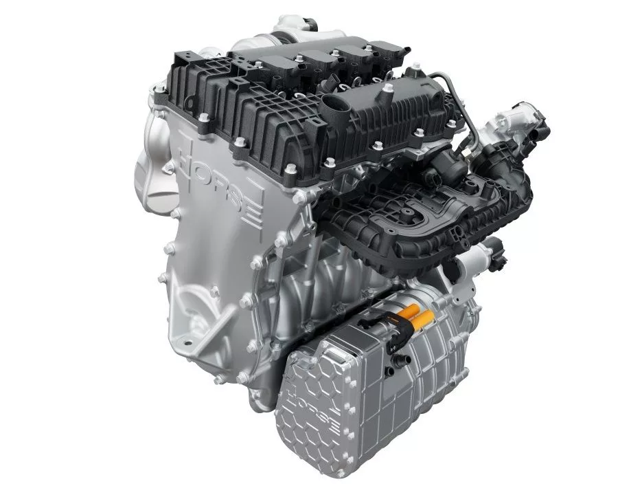

Horse Powertrain has unveiled a compact, all-in-one hybrid system that integrates engine, motor and transmission. Photo courtesy Horse Powertrain
September 5, 2025
MUNICH—Horse Powertrain has unveiled a compact, all-in-one hybrid system that integrates engine, motor and transmission. The Future Hybrid System replaces the front electric drive unit of EVs, providing an affordable way to convert them into hybrid EVs (HEVs), plug-in hybrid EVs (PHEVs) and range-extended EVs (REEVs).
Several versions are available for automakers, including performance and utra-compact variants. The former is 740 millimeters wide and employs two motors in a P1 + P3 configuration (one at the engine output shaft and another at the transmission output shaft). The latter 650-millimeter wide variant uses a motor in a P2 configuration (between the engine and transmission).
Both variants use a 1.5-liter, four-cylinder engine and dedicated hybrid transmission. They also contain the full suite of power electronics required for hybrid power trains and can seamlessly integrate with systems like a DC-DC converter, on-board charger and an 800-volt charging booster to maximize performance at low voltages.
Engineers are in the process of developing additional products that could increase the system’s compactness. These include three-cylinder variants that could reduce the unit’s width by an additional 70 millimeters.
