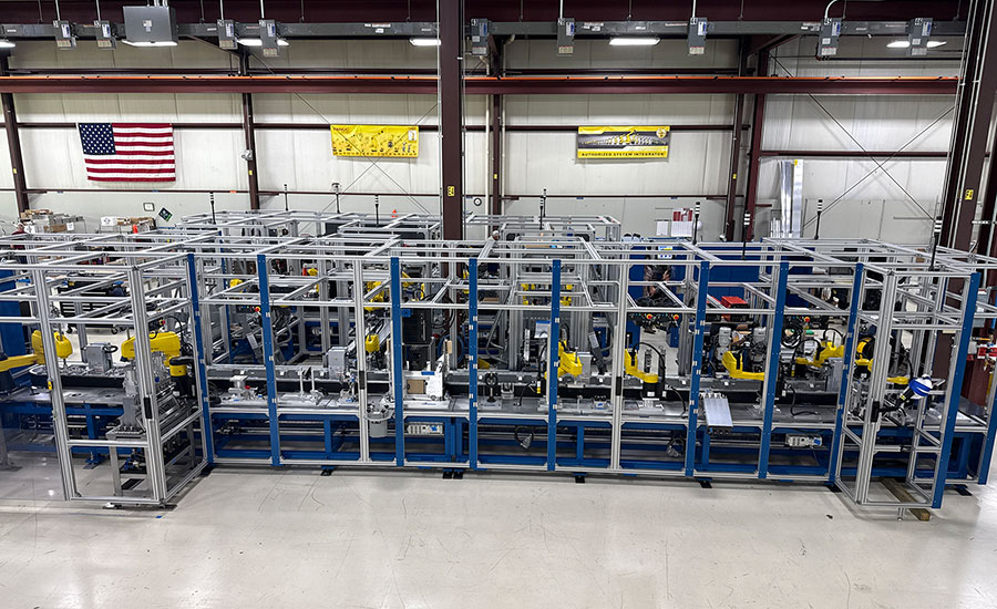

Multi-Robot System Assembles Valves
Image courtesy of Edgewater Automation
Edgewater Automation designed and built a fully automated, multi-robot assembly system for a manufacturer of industrial valves. The system achieves a 2.5-second cycle time with an OEE of 85 percent. It features 31 robots, two linear-motor transfer systems, and pallet-transfer conveyors. The system includes vibratory bowl feeders; custom end-of-arm tooling; robotic screwdriving and riveting; robotic dispensing and curing; press-fit assembly, laser marking and robotic packaging. Quality checks include fastener torque, fastener depth, rivet height, leak testing, and vision inspection.

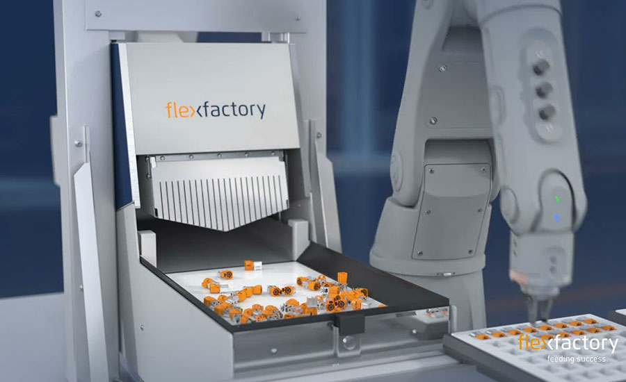

Feeder Is Flexible
Image courtesy of Flexfactory LLC
The flexfeeder XQS presents a variety of parts to a robot for pickup without the need for custom tooling. The feeder gently presents parts on an illuminated vibratory table. A conveyor is not necessary. An integrated vision system identifies parts in the correct orientation for pickup. Brushless servomotors and high-quality, durable components ensure maximum ROI. A touch screen interface simplifies parameterization and provides performance data on feeding. Quick-change conveyor surfaces are available in different colors, materials and surfaces.

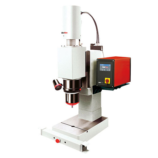

Orbital Riveters Are Modular, Flexible
Image courtesy of BalTec Corp.
The TN/E line of orbital riveters provide a force range from less than 1.5 kilonewtons to 35 kilonewtons. The line covers a range of applications and offers maximum flexibility for a variety of manufacturing processes. Thanks to a new adapter, the riveters can use orbital heads from other manufacturers, offering even more flexibility in production. The machines feature a protective device and meet CE standards—even without an enclosure—enabling the processing of larger, bulkier workpieces. Thanks to its modular construction, the machines can be integrated into existing systems and expanded with a range of accessories, including process control systems, hold-down devices, custom enclosures and automatic sliding tables.

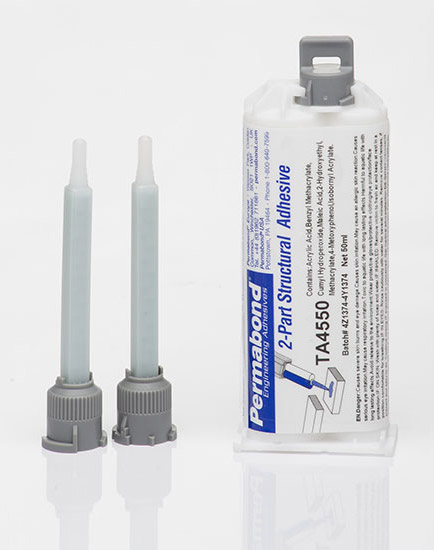

Adhesive Bonds Nylon
TA4550 acrylic adhesive
Image courtesy of Permabond Engineering Adhesives
TA4550 is a toughened acrylic adhesive that forms structural bonds with nylon and other substrates. This high-performance adhesive resists shear, impact, vibration, chemicals and environmental conditions. It bonds with nylon and other low-surface-energy plastics, such as polyethylene, polypropylene and PTFE. It also bonds metals and composites. This two-component adhesive is mixed at a 2-to-1 ratio. It requires no surface primers or additional surface treatment before bonding. This high-viscosity, non-slumping adhesive is formulated for controlled, accurate dispensing, even in vertical applications. It comes in 50- and 400-milliliter cartridges. It is also available in bulk. It cures quickly at room temperature.

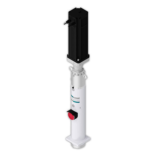

Servo Pump for Low Pressure, Small Shot Volumes
Servo Rod Pump (SRP) for PVA’s Endurance dispensing module
Image courtesy of PVA
A Servo Rod Pump (SRP) is the latest option for PVA’s Endurance dispensing module. The pump is ideal for dispensing medium- to low-viscosity materials with shot volumes of 100 cc or less. It bridges a gap for manufacturers who are interested in servo-driven metering technology, but do not require a high-pressure system. The SRP is a fully programmable metering system to precisely dispense material with and without abrasive fillers. The pump features a tungsten carbide metering rod with lip seals. The rod never contacts the cylinder walls. The rod’s bearing supports are external and do not contact any abrasive media. The mix ratio can be set from 1-to-1 to 10-to-1.
PVA | www.pva.net | Booth 1117

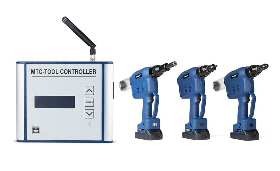

Controller for Blind Fastening
MTC tool controller
Image courtesy of Industrial Rivet & Fastener Co.
The MTC tool controller provides process control and data collection for the company’s full line of FreeSet cordless tools, including the RK-777C for blind rivets, RK-787C for rivet-nuts, and RK-797C for lock bolts. With the ability to manage up to 20 tools simultaneously through a wireless LAN, the controller prevents incorrect assembly by ensuring that each rivet is installed to specified parameters. The unit securely stores riveting data, ensuring traceability. Up to 100,000 results can be stored directly on the device. Programming is done through a web-based interface. All connected tools can be programmed directly via the controller. It supports multiple communication protocols, such as Ethernet and Profibus.

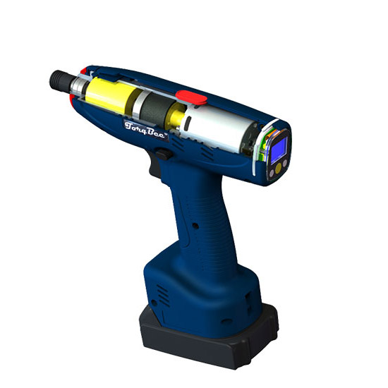

Tool Features Rotating and Static Torque Sensors
TorqBee EC2 series of cordless fastening tools
Image courtesy of HST USA Inc.
The TorqBee EC2 series of cordless fastening tools are equipped with both a rotating and a static torque sensor. The rotating torque transducer acts as a master and controls the tightening process. The static transducer monitors the results of the rotating transducer in real time to ensure that it is working perfectly. Both sensors work with different, clearly separated technologies. This redundancy ensures that the fastening process is always safe and reliable. The tools can be used for tightening class A bolts in accordance with the VDI/VDE 2862 standard. The tool can store 150,000 results and graphs from both sensors for process documentation. The tools can connect to a network through a built-in WLAN module.

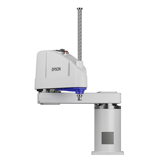

SCARA Robot Is Fast, Precise
GX-C Series SCARA robots
Image courtesy of Epson America
The GX-C Series SCARA robots are designed for the most demanding assembly applications. The robots are available in multiple arm configurations for increased productivity and worker protection while minimizing footprint. Gyroplus vibration reduction technology optimizes throughput by enabling high acceleration, smooth motion and fast settling time. The robots work with the RC800A robot controller, which optimizes run-time, recovery and error handling. SafeSense technology enables human-robot interaction without requiring a safety fence. Options include vision guidance, parts feeding, force guidance, conveyer tracking, and fieldbus connectivity. Four models are available covering a reach range of 250 to 1,000 millimeters.

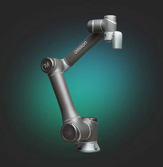

Cobot Is Easy to Program
TM S Series of collaborative robots
Image courtesy of Omron Automation
The TM S Series of collaborative robots are suitable for a range of applications. Five models are available covering a reach of 900 to 1,902 millimeters and payloads of 5 to 25 kilograms. With 31 safety features, the cobot meets ISO 13849-1 (performance level D) and ISO 10218-1 safety standards. Applications can be programmed using a built-in hand-guidance function: Engineers simply move the cobot’s wrist to the desired position, and with the click of a button, the position is taught. A touch-screen interface can be used as a teach pendant. The cobot has an integrated vision system. Engineers can set up applications for immediate deployment without having to integrate external cameras or lighting.
Omron Automation | https://automation.omron.com | Booth 505

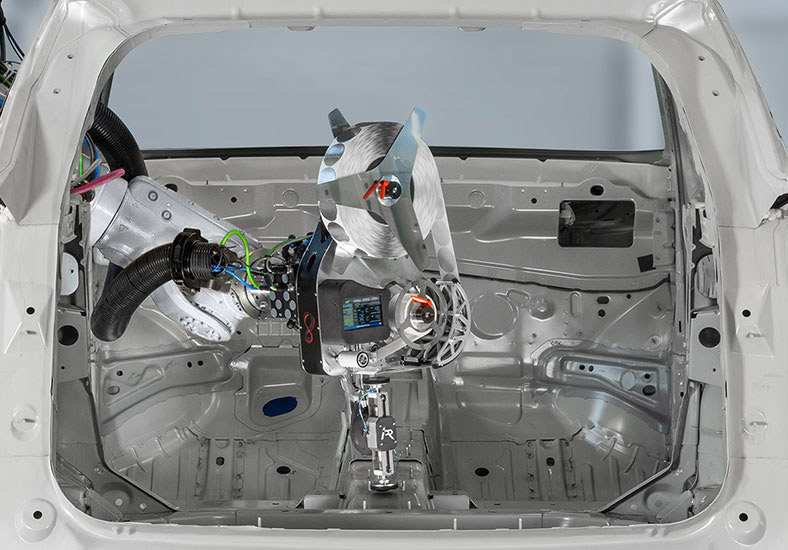

Robotic System Automates Sealing of Holes
PSH robotic hole sealing system
Image courtesy of IPR Robotics LLC
In the automotive industry, holes in car bodies often must be sealed prior to coating or painting. The PSH system is a fully automated, robot-assisted technology for reliably sealing holes and cavities in car bodies, batteries and other assemblies. The system accurately seals holes in seconds. Manual rework is not required. The system adapts easily to variations in hole diameter and part geometry. The system requires no disposable materials.
IPR Robotics LLC | https://en.iprworldwide.com | Booth 1518

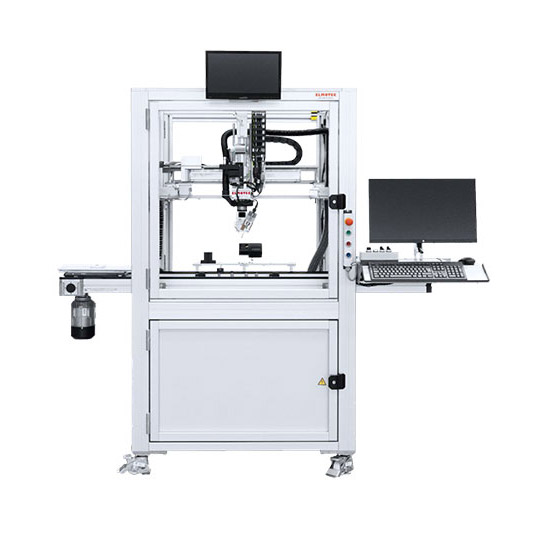

Modular Soldering Robot
SolderSmart MAX gantry-style robot
Image courtesy of Elmotec, by E-Tronix
SolderSmart MAX is modular gantry-style robot for automated soldering. Engineers can choose from three heating technologies: laser, induction or conventional soldering iron. The machine can be used as a semiautomic, standalone system, or it can be integrated with a transfer system for fully automatic, inline production. The feeder can accommodate wire diameters of 0.5, 0.8 and 1 millimeter. The system is equipped with a vision system for accurate inspection of soldered joints. The robot compensates for part misalignment by checking the position of fiducials. Process parameters and results are stored in a database. The machine can read bar codes and store data with part numbers.

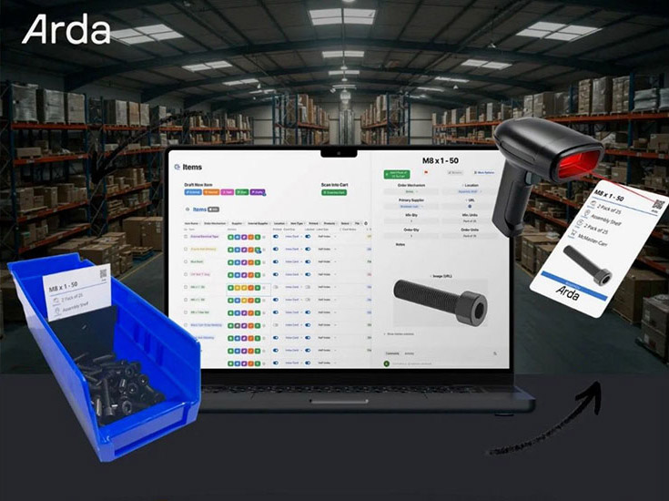

Free Software Generates Kanban Cards
Arda Cards
Image courtesy of Arda
Arda has launched a free online tool for creating kanban cards. Originating from the Toyota Production System, kanban is a visual method for managing manufacturing workflows. It operates on a “pull” principle, in which replenishment is triggered only when needed, minimizing waste, reducing overproduction, and ensuring a continuous flow of materials. Traditionally, this involves the use of physical kanban cards that signal the need for more parts or materials. Arda takes the concept into the 21st century by offering a sophisticated inventory management system that connects physical kanban cards to a robust digital platform. The cards have QR codes that, when scanned, trigger automated reordering processes, eliminating stockouts and providing real-time inventory visibility.

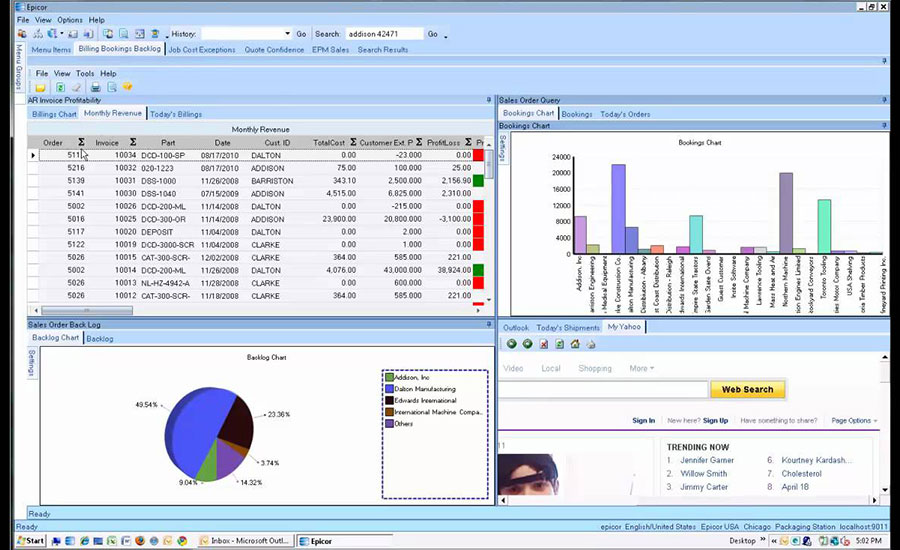

ERP Uses AI for Outcomes-Based Pricing
Epicor Prism Business Communications
Image courtesy of Epicor Software Corp.
Epicor Prism Business Communications is the first ERP AI agent with outcomes-based pricing. The software automates RFQ workflows and accelerates supplier communications, helping supply chain businesses cut cycle time, reduce manual work, and make fast, confident purchasing decisions. The AI agent meets users on a familiar channel they use every day—email communication—without requiring separate portals or predefined templates. Because the software understands Epicor’s unique ERP data structure built for the supply chain industries, the agent can carry on a conversation with a user and contextually translate email communications with suppliers such as “lead times,” “cost,” and “part ID” directly into the ERP.
Epicor Software Corp. | www.epicor.com | Booth 400

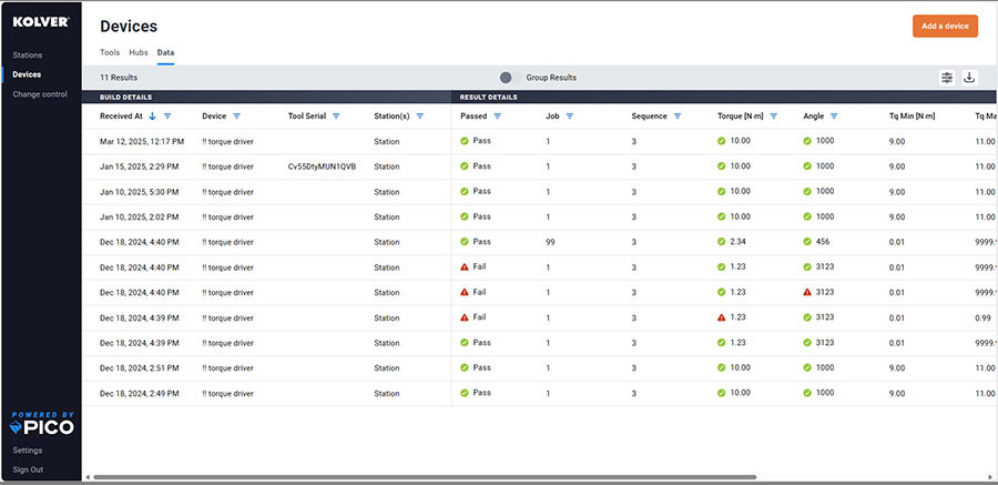

Automated Torque Data Collection Software
K-Net software
Image courtesy of Pico MES
Kolver, a supplier of fastening tools, has launched K-Net software for torque data collection. The software is brand agnostic; manufacturers can connect their favorite torque tools and collect torque and angle data, all through a single interface. Designed to replace manual data tracking systems, K-Net gives manufacturers complete visibility into their fastening operations, automatically and in real time. With one fee, manufacturers can connect an unlimited number of tools or spindles. No subscription is necessary, and there is no per-spindle licensing. K-Net is powered by Pico MES and sold exclusively through Kolver.
