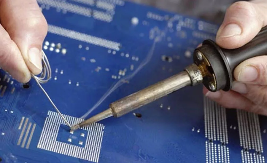

soldering a component onto a circuit board
Photo courtesy Altium
Tribal knowledge, such as a unique method of soldering a specific component, is often lost when an assembly line is transferred to another location.

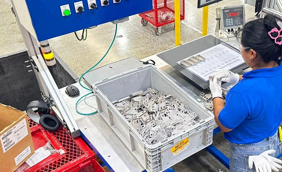

electronics assembly
Photo courtesy Ascension Automation Solutions
Often, documented work instructions don’t match the way the job is actually being done on the floor.

Consider a precision electronics supplier that transferred a mature subassembly line to an overseas location. The company’s documentation was up to date, and the team ran through a checklist. However, defect rates climbed post-launch. The root cause? Operators back home had always made a subtle hand-soldering motion to counteract thermal drift, a trick not mentioned anywhere. The “why” behind the touch was lost. Only after bringing an original assembler onsite did the team discover and bridge the gap. The line recovered—after weeks of waste.
