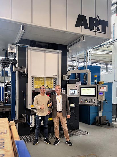

Peter Lund Pedersen from Grundfos and Peter Karlsson from AP&T
Peter Lund Pedersen from Grundfos (left) and Peter Karlsson from AP&T celebrate the installation of a one-of-a-kind servo press system they developed jointly. The system consumes 85 percent less energy per stroke than the previous press. Photo courtesy AP&T

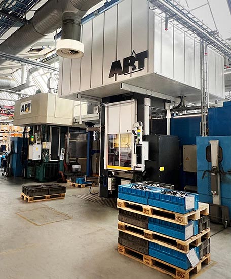

The new servo hydraulic press is integrated into an automated line with two other machines from AP&T. All are connected to a visualization system that shows energy consumption in real time, both machine by machine and for the entire process.
The press consumes significantly less energy than older machines. In fact, it’s 10 times more efficient than the old presses. “It makes it very clear that these are true energy savings on a large scale,” says Karlsson.

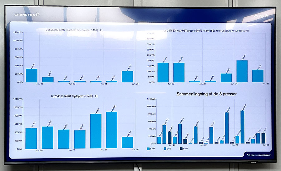

An HMI displays the energy data in real time during production. “This visualization has taken on an important function in our work,” explains Pedersen. “We use it to quickly detect deviations and drive improvements. It delivers a strong visual impact, especially compared to the older presses. We have an internal ‘green team’ that actively works to identify energy savings.”
monitoring the energy consumption of the press
Operators can monitor the energy consumption of the press in real time on a large display screen. Photo courtesy AP&T
