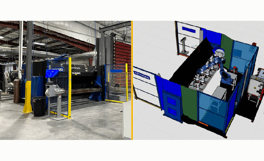

programming robot paths in a welding cell
For one assembly, programming the robot manually required 13 hours. With offline programming, the same task can be completed in under three hours. Photo courtesy Visual Components

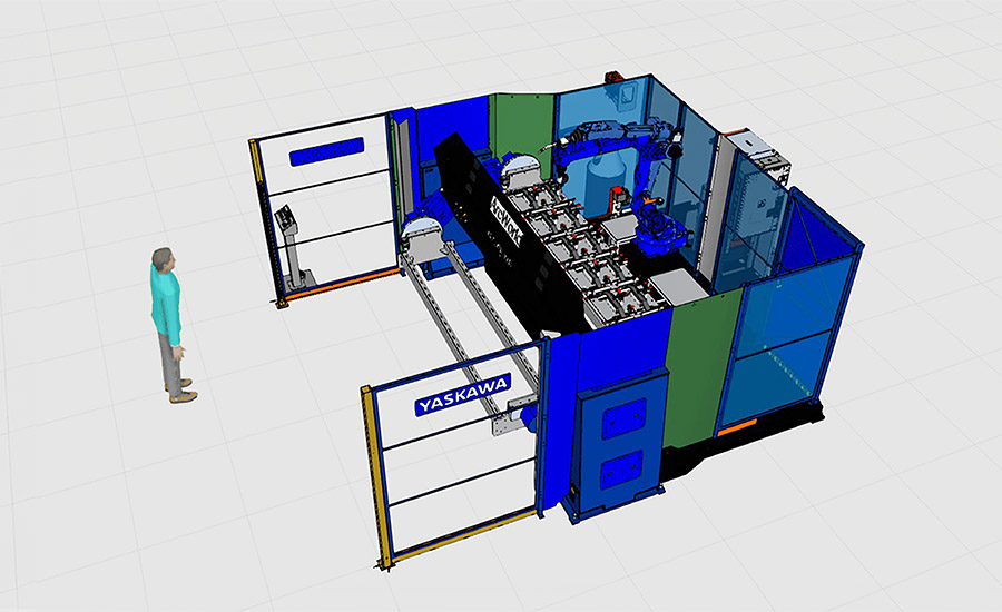

With just a few clicks, engineers can program multiple robot paths in a welding cell. Photo courtesy Visual Components
Yoder was blown away by the reduction in repetitive work. “The biggest difference was the number of points programmed by simply selecting a joint in the software,” he explains.
When an engineer chooses a single weld in the CAD file, the software automatically generates multiple lines of programming code for the robot. “And it’s not all simple movements,” he continues. “We have different fixtures where it takes a bit of maneuvering to place the welds, but the software handles them just fine with accuracy.”
