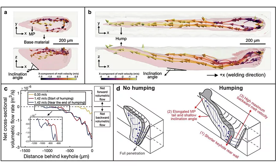

humping
Illustration courtesy Jingjing Li/ Pennsylvania State University
Humping typically occurs when laser welding speed surpasses a critical threshold.

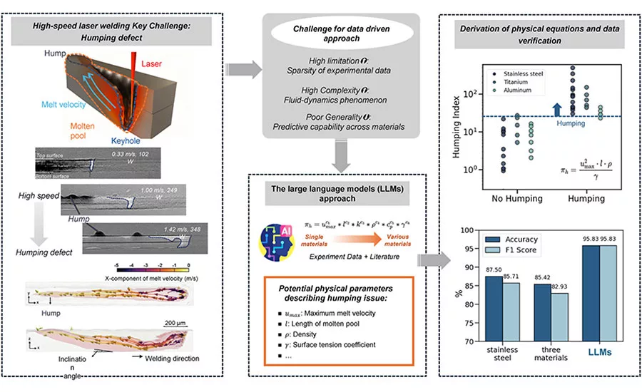

welding defects
Welding defects can occur when a laser beam moves faster than the molten pool can form and stabilize.

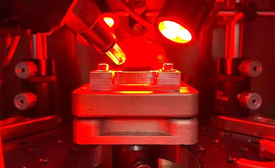

laser welding
Photo courtesy Caleb Craig/ Pennsylvania State University
Engineers are exploring how laser welding variables such as power, wavelength and travel speed can affect joint quality.

“With high-speed laser welding, defects will occur when the laser beam moves faster than the molten pool can form and stabilize,” says Jingjing Li, Ph.D., a professor of industrial and manufacturing engineering at Pennsylvania State University. “Common defects are humps and bottom cavities.
“Different laser welding and work materials may have different defects, such as porosity, cracking and undercut,” explains Li. “Humping typically occurs when the welding or scanning speed surpasses a critical threshold.
“It directly limits the maximum welding speed, thereby constraining overall productivity,” warns Li. “And, it poses difficulties in achieving a smooth surface finish and a consistent weld strength.”

Li and her colleagues used 48 total datasets to develop their framework, five of which came from their own experiments and 43 from existing research. They used the data from their experiments, including types of metal and frequency of humping, to develop candidate equations representing specific variables and their relationships. Then, they developed a rubric to use as the LLM processed existing scientific literature.
The LLM could identify relevant information, convert the correct data and recommend equations most likely to describe how different physical parameters would influence the quality of a weld or whether the weld would experience humping.
While the process of selecting an equation is not fully automated by the LLM, it is much more efficient and generalizable than previous approaches. Using the framework, 10 equations can be generated in about one minute, which is much more efficient than the hours of research it takes to create one equation with traditional methods.
The engineers then score and rank the equations based off the developed rubric, using the equation with the highest score.
“We use the physical parameters of the weld like melt velocity, thermal conductivity and density to determine how the equation is going to be applied,” explains Li. “This still requires a lot of domain knowledge from other researchers, but can be built upon, and keeps our equations standardized across different materials and physical properties.
