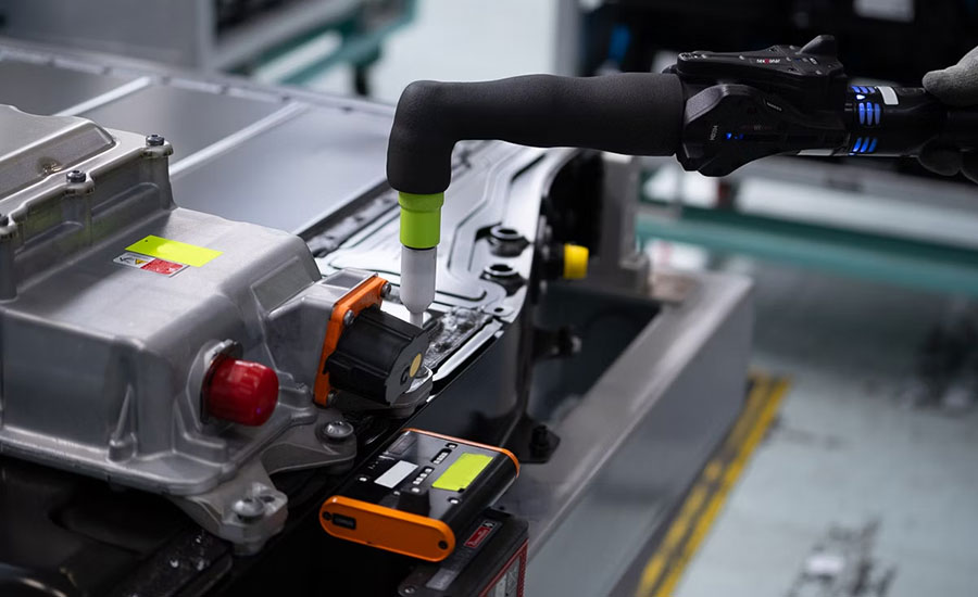

Nexonar integrates seamlessly with the factory’s traceability system. Photo courtesy Desoutter

Each assembly station is equipped with an infrared camera positioned at a height of 3.5 meters above the MPB. A reference tracker is attached to the assembly while one or two other trackers—depending on the tightening angle—are installed on the screwdriver.
The Nexonar system offers the option of specifying the fastening sequence for the operator or working in “free order mode.” To support the assembler, a screen displays instructions for each fastener to be installed. Tightening is only permitted if the tool is correctly positioned on the correct screw. The results obtained at each joint are transmitted in real time to factory’s traceability software.

Nexonar detects each fastening location to within ±15 millimeters, even when the camera is positioned several meters above the working area. Photo courtesy Desoutter
In the case of MPB, the minimum distance between two screws is 30 millimeters. The complete system—including camera, reference tracker and tool trackers—allows detection and recognition of each fastening location to within ±15 millimeters, even when the camera is positioned several meters above the working area. This exceptional precision eliminates any risk of inversion of tightening torque for the same screw dimension.
