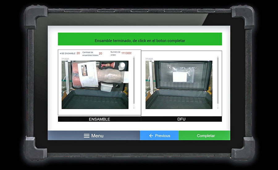

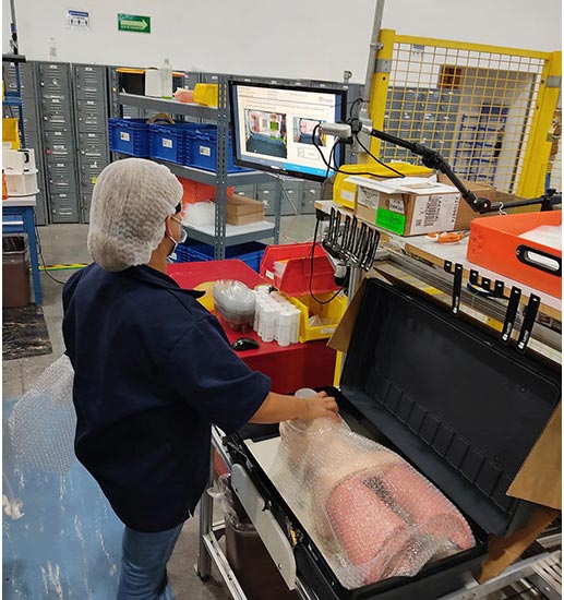

The system built by the Laerdal team works behind the scenes, continuously monitoring the kits as they are assembled. As workers pick parts and place them in a crate, Tulip Vision automatically recognizes the parts and checks them off the bill of materials. Once all parts have been placed, a photograph of the kit is captured for future reference and remote visual inspection, and the technician is allowed to ship the kit.
This simple system ensures that the kits are complete, provides a digital reference for potential warranty claims, and allows the team to identify and drive improvements within the process.
Tulip Vision is a versatile, powerful tool that lets operations teams build custom vision-enabled apps without writing a single line of code. To build the error-proofing system at their assembly plant, the Laerdal team purchased one of the recommended off-the-shelf cameras available from many retailers and built an app to guide technicians through kit assembly.
The team set up the cameras to face down at each assembly station, and hooked them up to Tulip Vision. This allowed technicians to pick parts without having to adhere to a particular order, or manually check off parts from a long list of bill of materials. It also served as a visual aid during production, and as a future reference for process improvements.
Tulip Vision software
As workers pick parts and place them in a crate, Tulip Vision automatically recognizes the parts and checks them off the bill of materials. Photo courtesy Laerdal Medical
