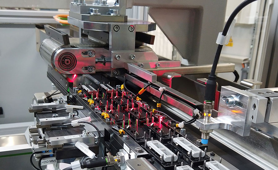

A key element of the line is PIA Automation’s blade-handling modules, which singulate the razor blades and insert them into a cartridge.

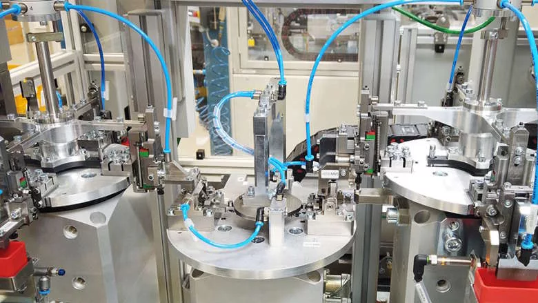

The system features two parallel high-speed transport systems to deliver consistent quality and reliability. Photo courtesy PIA Automation
Given the enormous production volumes, disposable razors are assembled on high-speed automated lines. Systems integrator PIA Automation of Evansville, IN, recently designed and built just such a system.
Specifically, the system assembles and packages razor cartridges for personal shavers. The system features two parallel high-speed transport systems to deliver consistent quality and reliability under demanding production conditions.
Each cartridge must meet strict requirements for a close, comfortable shave. The thin, hardened and sharpened blades require precise handling, repeatable assembly and stable high-speed processing. To meet these demands, PIA Automation worked closely with the customer to develop a fully automated system capable of high-volume production while maintaining high quality.
“Our multi-blade stations are specifically engineered for high-speed applications of this kind,” says Tim Schuller, product manager at PIA Automation. “As part of this project, we further optimized the technology for both blade singulation from the magazine and precise insertion into the cartridge frame. The result is a highly stable, low-wear assembly process that ensures reliable long-term operation at maximum throughput.”
A key element of the line is PIA Automation’s blade-handling modules, which singulate the razor blades and insert them into a cartridge. The process must be done quickly and precisely, without nicking, bending or dulling the blade.
The system includes six of these modules, which are connected by two parallel transport systems. Each module is equipped with fully automated infeed and outfeed functions, ensuring a continuous flow of parts while allowing targeted decoupling of individual process steps.

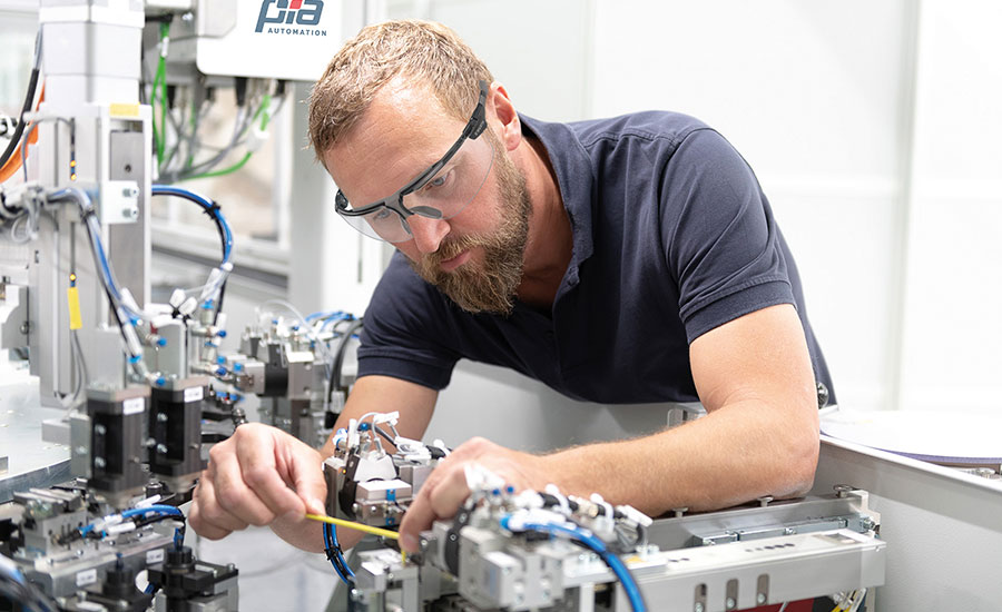

technician fine-tunes a handling mechanism for an automated assembly system
A technician fine-tunes a handling mechanism for an automated assembly system. Photo courtesy PIA Automation
“Assembly cycles with longer cycle rates can be executed multiple times within the same line without reducing overall output,” said Schuller. “The workpiece carriers are distributed across several cycle-critical stations, helping avoid any unnecessary downtime.”
