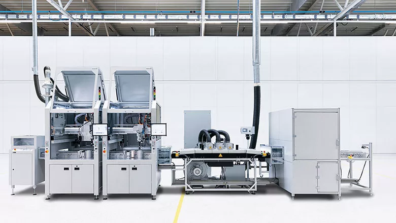

assembly system
This automated system assembles an EV battery sensor every 13 seconds.
Photo courtesy Dr. Hönle AG UV Technologie

Recently, bdtronic and Hönle cooperated to create an automated inline, five-step system for CIPG dispensing and curing. In the first step, the component contours are treated with plasma at atmospheric pressure to achieve better adhesion of the sealant. In the second and third steps, the highly viscous CIPG material is applied in contours. In the fourth step, curing is carried out using a Hönle UV curing system. Step five involves the optical inspection of the finished part to ensure quality and consistency.

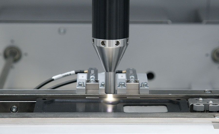

plasma treatment
(A)

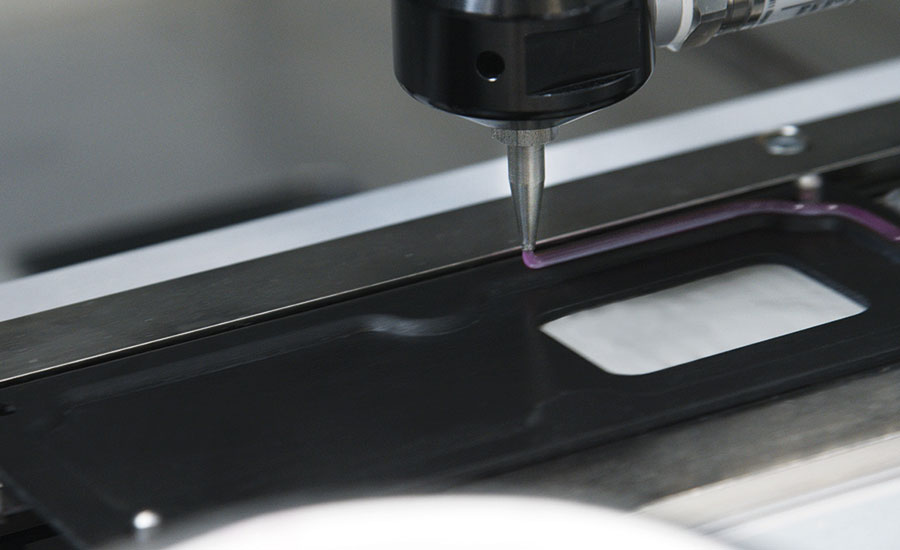

dispensing material inside
(B)
dispensing material outside
(C)

These images show each step in the gasketing process: plasma treatment (A), dispensing the material inside (B) and outside (C), and UV curing (D). Photos courtesy Dr. Hönle AG UV Technologie

For this specific project, the manufacturer had a production target of 6,000 sensors per day, or one assembly every 13 seconds. A one-component CIPG material would need to be dispensed on a metal part with an complex shape.

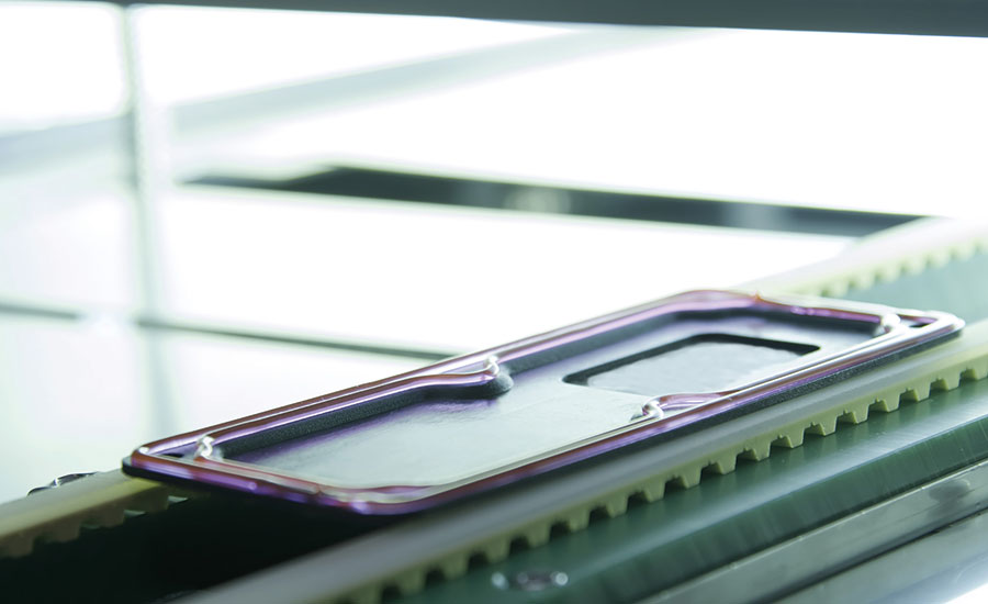

optical inspection
In the final step, all parts undergo an optical inspection to ensure the quality of the seals. Photo courtesy Dr. Hönle AG UV Technologie

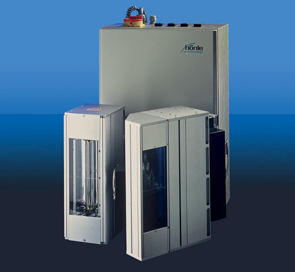

Uvaprint curing system
The Uvaprint curing system outputs a maximum power of 200 watts per centimeter. Photo courtesy Dr. Hönle AG UV Technologie
The Hönle Uvaprint curing module was identified as the optimal curing system for this material. With its Cold-Mirror technology, the Uvaprint system ensured that the temperature on the substrate did not get too high despite the high intensity radiation. In the production process, the components pass through three consecutive Uvaprint modules, which provide a full cure before the sensors move to step five for optical inspection.
The manufacturer now has an assembly line that allows for process and planning security, delivering a high-quality battery sensor every 13 seconds.
