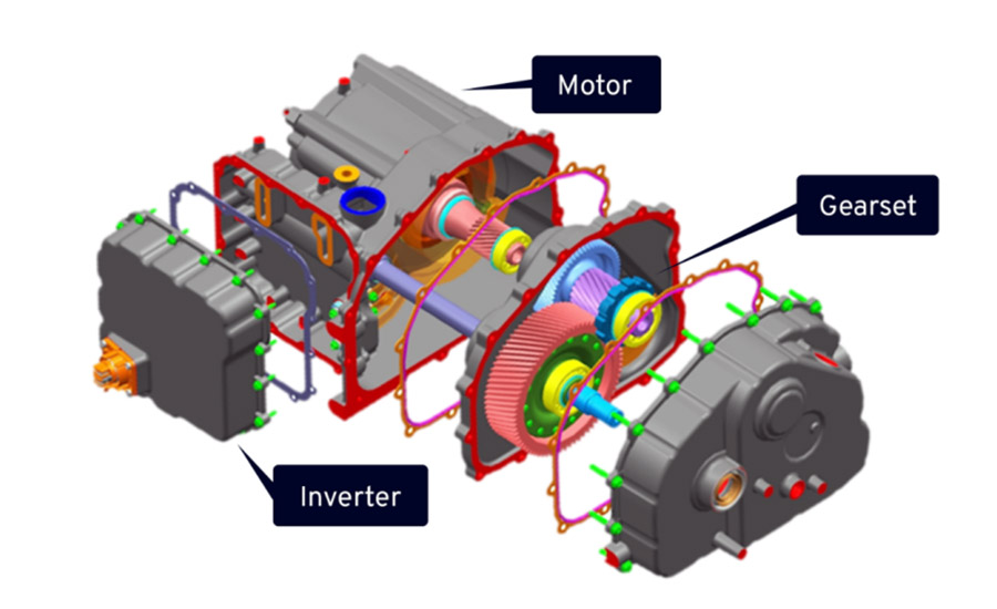

electrical components in an EV
Illustration courtesy Aumovio Engineering Solutions
Power electronics dictate the way that electrical energy flows throughout EVs.
