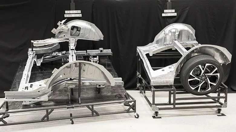

large front and rear castings
Photo courtesy Toyota Motor Co.
Large front and rear castings can eliminate hundreds of stamped and welded metal parts.
