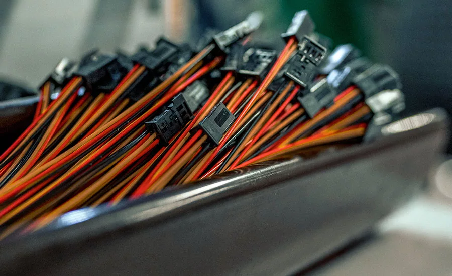

Terminated wires await assembly into a harness.

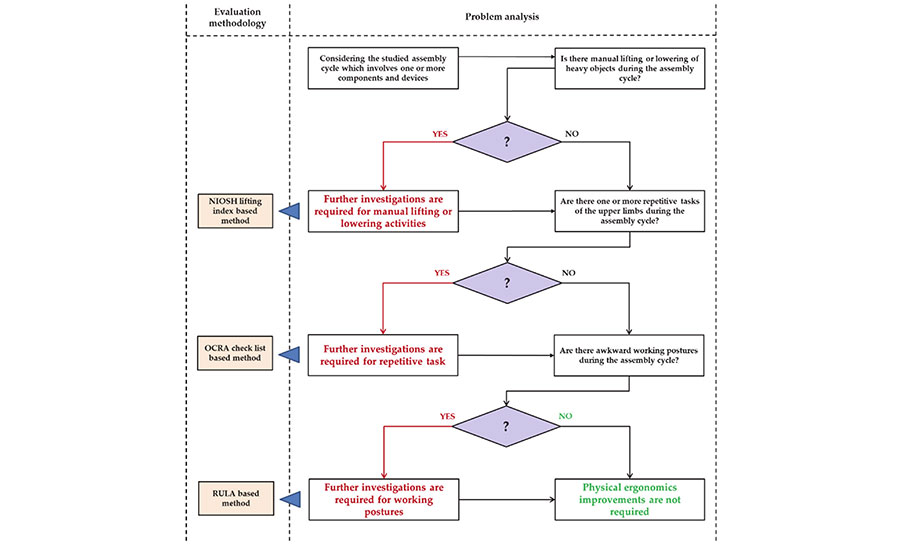

Flowchart illustrating an ergonomics evaluation process for assembly operations, assessing manual lifting, repetitive tasks, and working postures using NIOSH, OCRA, and RULA methods.
This decision tree provides a framework for identifying nonergonomic tasks that could be improved with the help of a collaborative robot. Source: Free University of Bozen-Bolzano

Our first step was to assess the ergonomics of the existing assembly process. Ultimately, we would want the cobot to handle the most physically demanding tasks.
To do that, we began with the ergonomic assessment method outlined in ISO Technical Report 12295. We focused primarily on the neck, trunk and upper limbs, concentrating on handling heavy objects, repetitive tasks, and awkward postures.
