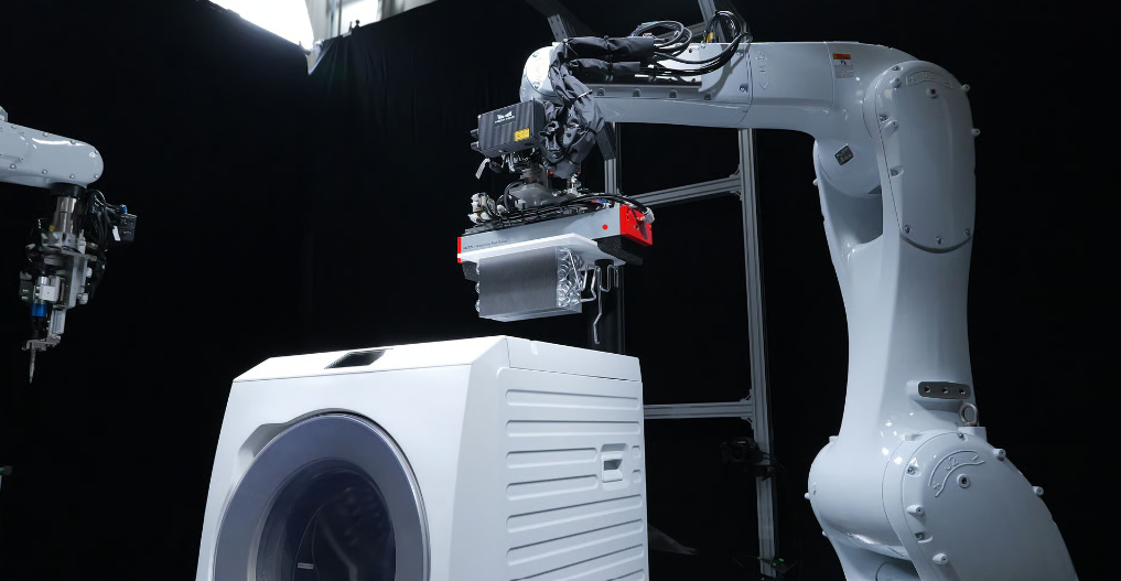

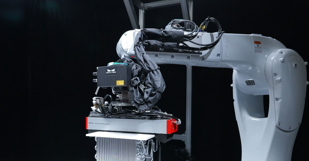

Robots are used to remove and install heat pumps used in washing machines. Photo courtesy Panasonic Corp.

Industrial robot handling a household appliance during an automated disassembly process for recycling, inspection, or material recovery operations.
Panasonic engineers are using six-axis robots to disassemble air conditioners, microwave ovens and washing machines. Photo courtesy Panasonic Corp.

“After analyzing repair data and current designs, we have developed circular friendly improvements,” explains Murphy. “A great example are the heat pumps used in washing machines.”
Panasonic pioneered the use of heat pump technology for drying efficiency. By moving the device from the bottom to the top of their machines, engineers made this key component more easily accessible for repair.
The heat pump can now be easily cleaned and maintained to provide a longer life time for the entire washing machine. The design change also resulted in a 50 percent reduction in the amount of time it takes to repair a machine.

Panasonic engineers are programming six-axis robots to disassemble air conditioners, microwave ovens and washing machines. Magnetic grippers lift the cover off appliances, while screwdrivers remove fasteners. End effectors equipped with other types of tools cut wires and carefully remove components.

“The automatic dismantling equipment use machine vision technology to capture images,” says Murphy. “By using AI, the cameras accurately detect screws even with dirt or rust on the units. Then, it positions a robotic arm equipped with a screwdriver to remove the fasteners.”
