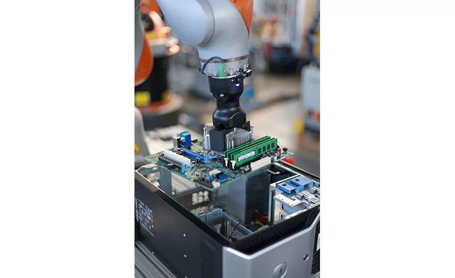

robotic disassembly of motherboards and other electronic components
Robots are used to disassemble motherboards and other electronic components used in computers.
Photo courtesy Fraunhofer Institute for Factory Operation and Automation

The disassembly process starts based on this high-level information. A robot receives a series of instructions and operations to complete, such as “remove two screws on the left of the housing.”
The skills specified in the disassembly sequences include robot actions, such as screwing, lifting, cutting, extracting, localizing, repositioning, releasing, moving levers, bending, breaking and cutting wires. According to Saenz, the disassembly robot can perform all of those tasks completely autonomously.
“The demonstrator even succeeded in tests to remove a motherboard from a computer—a very complex task that requires a high level of precision,” explains Saenz. “We used AI for that.”
