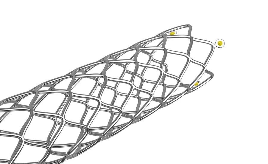

Precise adhesive application is also essential for assembling stents, particularly those made from materials with low radiopacity, such as nitinol. Such stents are difficult to see in X-ray images. To enable precise positioning in the body, tiny radiopaque markers are applied to the stents. For this purpose, gaps of just 15 to 30 microns are filled with minute quantities of adhesive. These micro-doses preserve the stent’s mobility, maintain its flexibility, and ensure long-term biocompatibility.

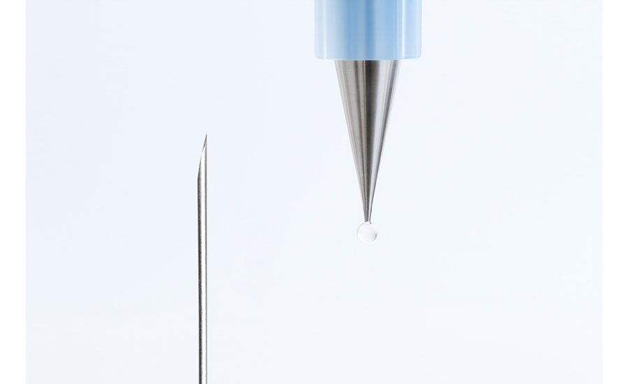

Some medical device assembly applications require dots of adhesive that are less than 2.5 millimeters in diameter. Photo courtesy ViscoTec.

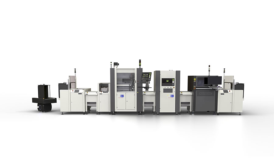

Rehm Thermal Systems can provide a complete automated system for dispensing and curing adhesives on medical devices. Photo courtesy Rehm Thermal Systems.

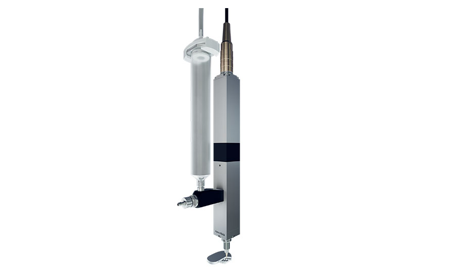

ViscoTec offers several options for microdispensing applications in medical device assembly. For example, the company’s new Vipro-Head dispensing valve is designed specifically for medical device assembly. All contact parts are made of stainless steel or FDA-certified plastics and elastomers. An autoclavable variant can withstand temperatures of up to 121 C.

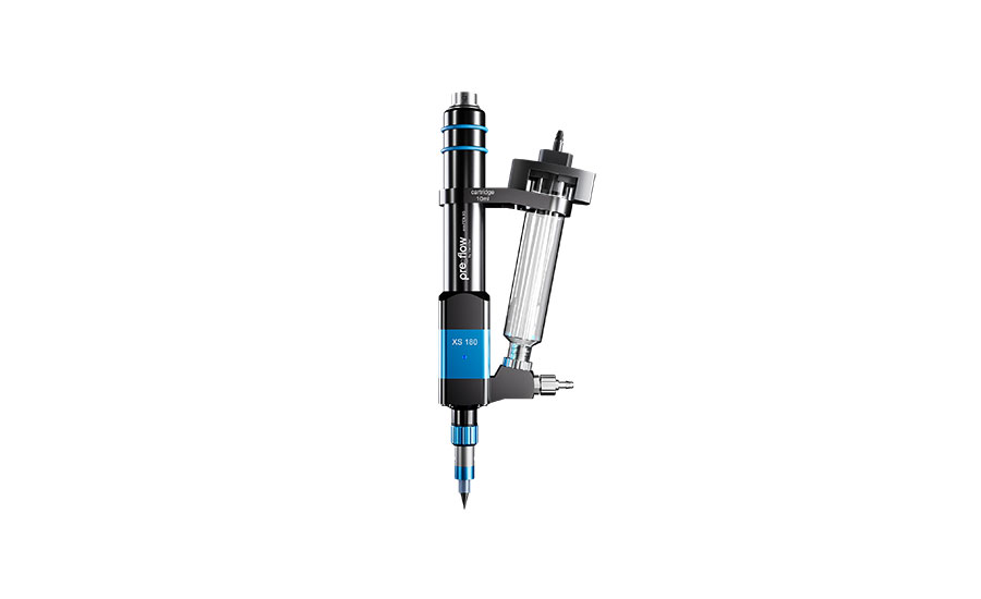

Another option is the Preeflow Eco-Pen XS 180. It is designed for ultra-small dispensing volumes. Its compact design facilitates integration into automated assembly systems and enables parallel operation of multiple valves.
The Preeflow Eco-Pen XS was developed specifically for the smallest dispensing volumes. Photo courtesy ViscoTec.
With dispensing accuracy of up to ±1 percent, adhesive quantities in the microliter range can be applied precisely and reproducibly.

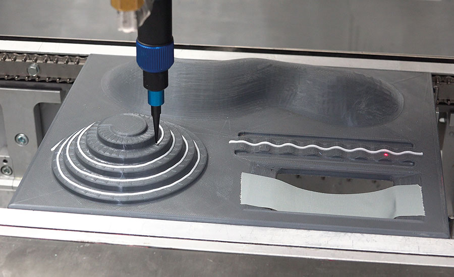

To determine location and position, even for soft or complex-shaped medical products, the systems feature automatic needle measurement, which checks the applicators at defined intervals and automatically readjusts them if necessary. An integrated fiducial camera detects alignment marks, corrects the zero point, and ensures precise operation, even if the assembly is not positioned accurately in the fixture. In addition, a 3D height sensor automatically compensates for any warpage or instability, which can happen with thin substrates.
An integrated 3D height sensor enables this automated system to dispense adhesives on parts with complex geometries. Photo courtesy Rehm Thermal Systems.
