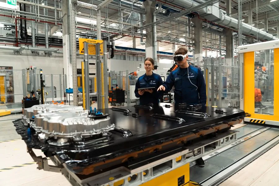

BMW is using virtual reality technology to build EV batteries at its new assembly plant in Woodruff, SC. Photo courtesy BMW AG

“All production staff complete a VR training program developed on site,” adds Rich Everly, vice president of production at BMW Group Plant Woodruff. “Within a virtual factory, they can practice real manufacturing operations under realistic conditions.
“This virtual environment replicates the plant’s production lines in meticulous detail, requiring only a set of VR goggles and a PC,” says Everly. “The training helps employees develop an understanding of relevant processes and builds confidence in operating the equipment before using the actual manufacturing systems for the first time.”
