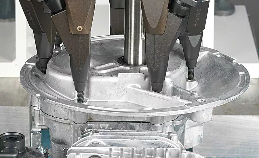

Finally, assemblers have several choices for the tooling at the end of the driver. This tooling consists of two parts: the mouthpiece, which accepts the fastener from the feeding tube, and the nosepiece, which captures the fastener and presents it to the bit. The most common type of nosepiece holds the head of the screw with a pair of jaws. When the bit engages the screw, the jaws swing open. Another type of nosepiece uses three or four spring-loaded balls to catch the fastener head. When the bit contacts the screw and pushes it forward, the balls are pushed out of the way.
When designing an assembly, engineers should remember to provide enough space for the driver's nosepiece to access the holes. "There has to be enough room for the jaws of the screwfeeder to get into that space and spread apart while the screw is being driven," says Maio.
How much room to provide depends on the design of the tooling and the type of fastener, but 1/8 inch on all sides is a good starting point. "If the fastener has an internal drive, like Phillips or Torx, you'll need less clearance than if the fastener has an external drive, like a hex head, because you have to account for the socket," explains Glenn. "Sometimes, you can get thin-walled sockets, but they don't withstand a lot of torque."
