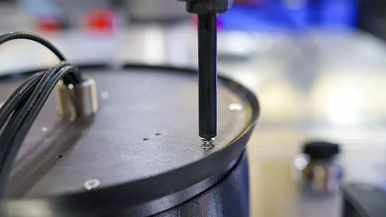

installing small-diameter screws
Automated equipment is often a necessity for driving screws with shaft diameters of less than 4 millimeters.Photo courtesy Visumatic

Once the screw is on the bit, the next step is to drive it. Because the target is so small, aligning the fastener with the screw location prior to insertion must be done carefully. Missing the hole might result in a scratched and rejected part. Templates are one solution to this problem.
The template is attached to the parts fixture with a hinge. Holes in the template correspond to the screw holes in the part. Prior to fastening, the parts are placed in the fixture and the template is laid over them. The screws can then be driven through the holes in the template, which are tapered to direct the nosepiece of the driver into the screw holes. This makes it easier for the operator to find the holes.
