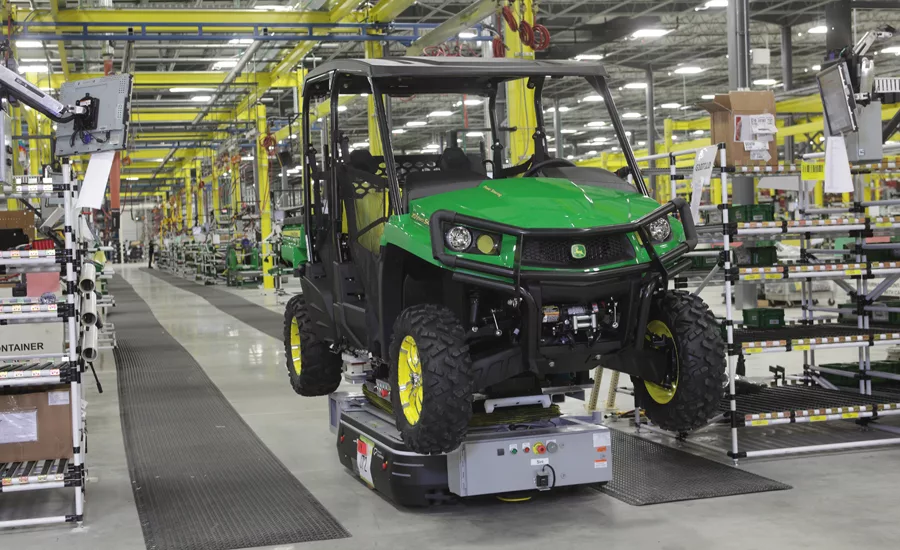

The Deere & Co. assembly plant in Augusta, GA, uses automated guided vehicles (AGVs) to build the company's Series 5000 tractor. In an integrated and networked process that takes less than 4 hours, each AGV transits a 1,452-foot assembly line along which approximately 3,500 tasks are performed as each tractor passes through 106 workstations.

Because of the complexity of its operations, Deere needed a leak-detection tool that could be integrated into the automated assembly process. This meant reliably and consistently performing within the cycle time allowed at each workstation along the AGVs' path.
