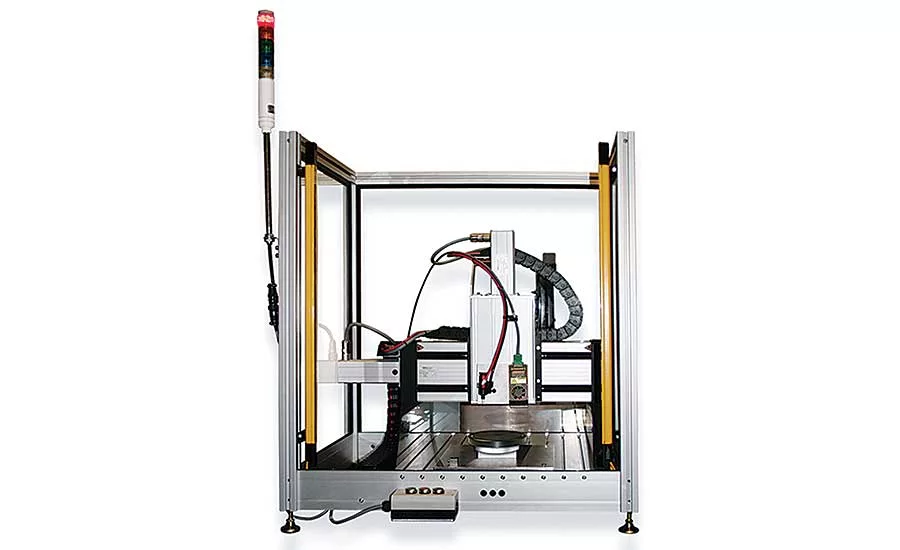

Fundamentally similar to modern 3D printers, gantry cartesian dispensing and curing robots follow plotted x, y, z coordinates and timing queues to precisely dispense UV curable sealant. Once dispensing is completed, the curing is accomplished moments later by repeating the dispensing motions with a high intensity UV cure light. These machines put manufacturers in charge with options to select from multiple pre-programmed patterns at the touch of a button. This allows manufacturers to efficiently apply sealants to components of different shapes and designs without duplicating the machinery needed to process the component. Additional features such as machine vision inspection, pass/fail technology, part placement, removal and even complete integration into existing manufacturing assembly lines are all available options.
A benchtop gantry dispensing robot offers many more uses than sealing gasket patterns. By flushing the system between each run, multiple materials can be used. Adhesives, sealants and lubricants of all types can be applied with a high degree of accuracy. One series of components may be prepared with UV Cure-in-Place gasket while the next set of components is pre-applied with anaerobic thread lockers and in yet another run, a sensitive electronic motherboard is protected with a shallow potting material. When handled correctly, this single machine can become a manufacturing hub supporting every phase of production.
