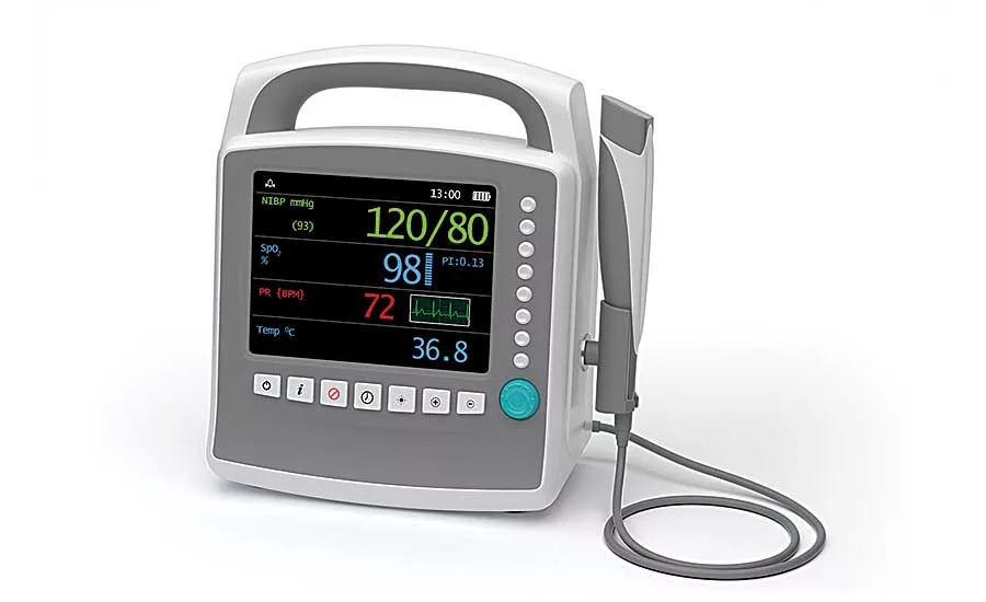

Medical device housings can crack, discolor, and become brittle or sticky after repeated exposure to the aggressive disinfectants. A new testing protocol helps engineers compare materials. Photo courtesy Eastman Chemical Co.

Medical device housings can crack, discolor, and become brittle or sticky after repeated exposure to aggressive disinfectants. The choice of plastic can therefore have a significant impact on the service life of a medical device.
To help manufacturers select a plastic that withstands the full spectrum of disinfectants used to prevent hospital-acquired infections, Eastman Chemical Co. has developed a simple test to measure the performance of different plastics. The replicable, four-step process demonstrates the impact resistance and durability of plastics after being exposed to disinfectants or other chemicals.
The protocol is designed to help manufacturers choose a material for myriad medical device applications, such as MRI coils, ultrasound probes, buttons, handles and portable equipment prone to wear and tear on hospital floors.
