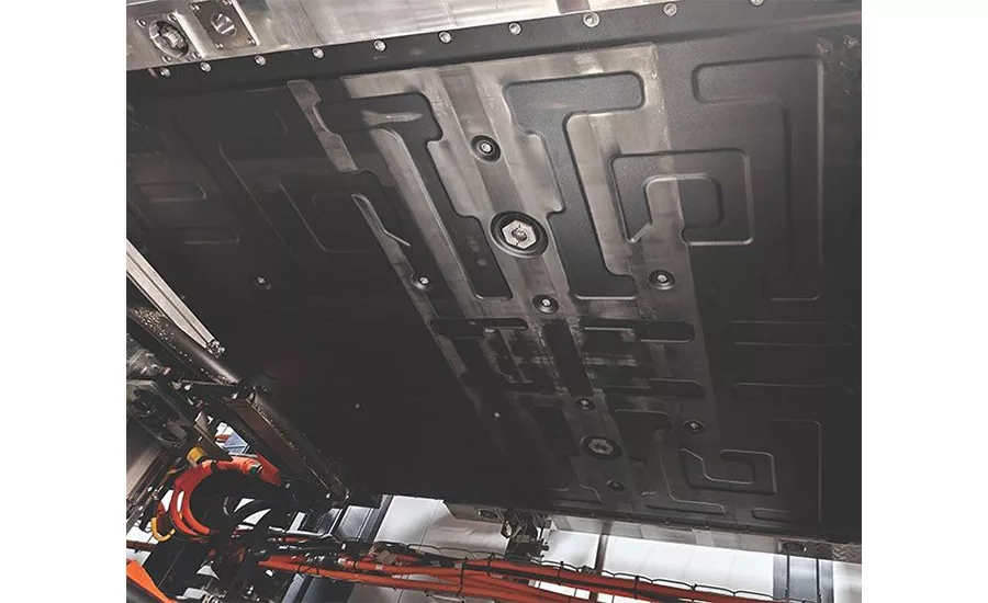

NIO and AkzoNobel were cited for a bottom plate coating for battery packs (see photo above). “[Engineers] extended the lifespan of the bottom plate coating from 5 to 15 years while reducing coating thickness by 90 percent, cutting vehicle weight by 2.2 kilograms and pioneering powder coating technology for electric vehicles,” says Mahalingam. “The innovation replaced nonrecyclable materials with recyclable alternatives, eliminated VOC emissions and improved coating efficiency by 55 percent, delivering significant sustainability benefits.”
