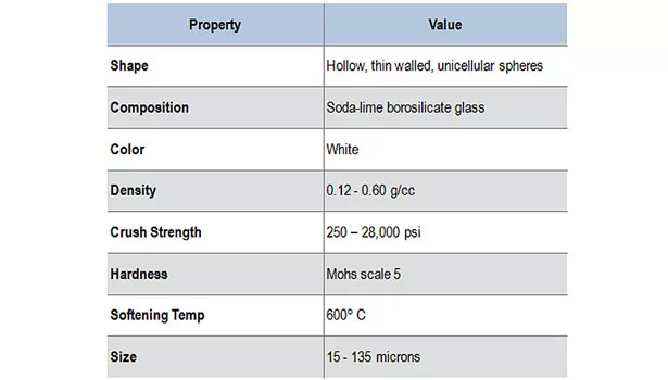

Additives, especially inorganic solid particulates, have greatly contributed to the growth of the polymer industry. They render polymers with improved mechanical, physical, electrical, thermal and dimensional properties, depending on their geometry and chemistry. Glass bubbles are finely dispersed, free-flowing powders consisting of thin-walled (0.5-1.5µm) spherical glass particles with an average diameter of 15-65µm (see Figure 1).
Glass bubbles were developed in the 1960s as an outgrowth from the manufacture of solid glass beads. They are commercially manufactured by melting a unique glass formula that contains a latent blowing agent causing the molten glass particles to expand into a hollow bubble. The resultant glass bubbles are chemically stable, water resistant and compatible with many materials used for indirect food contact applications. The material technology has evolved in recent years to produce bubbles with a high strength to density ratio which enables their use in demanding polymer processing operations.

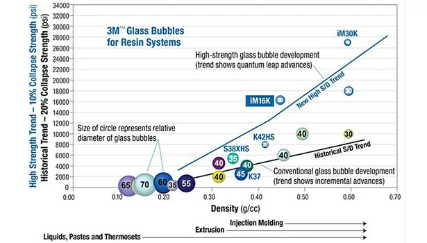

The choice of a specific bubble for a given application is important to maximize density reduction and to minimize cost-in-use. Not all glass bubbles can survive all polymer processing methods. As shown in Figure 2, the relationship of strength to density is important in selecting the lowest density glass bubble that will survive the process. With thermoset materials like polyurethanes and epoxies the predictive step in the process is the type of mixing system used. For high shear thermoset mixers such as Cowles mixers, a 3000 PSI bubble or higher strength material is generally required. For thermoplastics and rubber where there is only an extrusion process involved (e.g. sheet extrusion for thermoforming), then typically at least a 5000 PSI bubble is required. Injection molded thermoplastics require the highest compressive strength bubble – generally 16,000 PSI or greater. Finding the lowest density bubble that survives the process will insure the lowest cost in use since the least amount by weight will be required to achieve the targeted composite density.

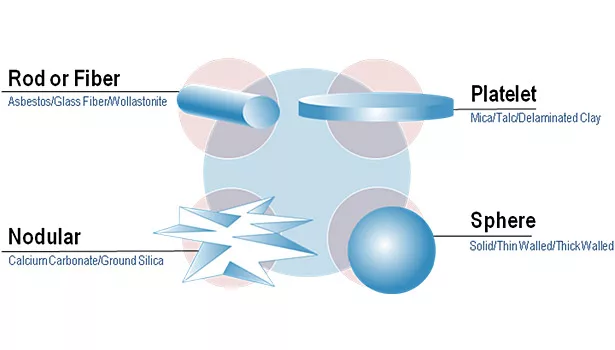

In injection molding, shrinkage and warpage constitutes a major problem resulting in decreased productivity. Comparing the geometry of glass bubbles to other fillers in Figure 3, the spheres stand out as being isotropic and create isotropic physical properties in composites. Since they are spherical they do not align in the polymer flow direction like high aspect ratio fillers such as fibers or talc and therefore have a better balance with respect to CLTE, impact, strength and other physical properties.

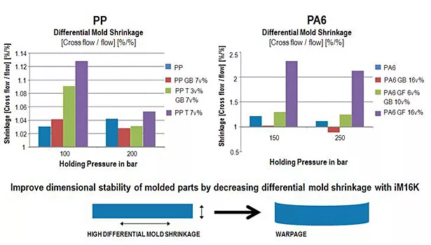

Glass bubbles decrease the amount of differential shrinkage which results in reduced warpage compared to high aspect ratio fillers are used. An example is shown in Figure 4 for glass fiber filled nylon 6 and talc filled PP. Differential shrinkage is shown as a result of different amounts and types of fillers as well as different post injection hold pressures (pack pressure). Differential shrinkage is higher in the cases where there is high aspect ratio filler present (fiber or talc) without glass bubbles.

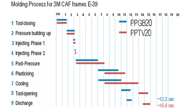

Productivity improvements can occur with the addition of glass bubbles. This is due to faster cooling cycles such as in injection molding or thick extrusion profiles. The overall volumetric heat capacity of glass bubble filled polymers is lower than that of their unfilled counterparts resulting in faster cooling from the melt. A study was made at 3M on an injection molded cabin air filter frame where PP containing 20wt.% talc was reformulated by removing the talc and adding the same amount of glass bubble on a volume basis. Figure 5 shows the cycle as a function of time (seconds) for the talc system (PPTV20) vs. the glass bubble containing material (PPGB20). The optimized cycle was reduced 3.4 seconds with PPGB20 compared to a total cycle time of 16.6 seconds with PPTV20. This is a 20% reduction in cycle time or, stated in terms of productivity, a machine that is capacity constrained can make 20% more parts in a given period of time.
