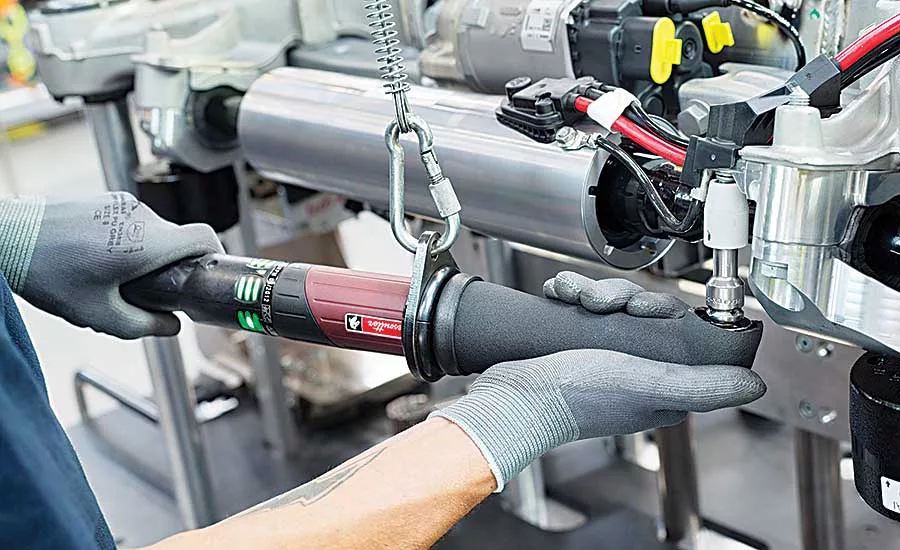

Using a handheld angle wrench, a Rhenus SML assembler tightens various brackets on an axle. Photo courtesy Desoutter GmbH

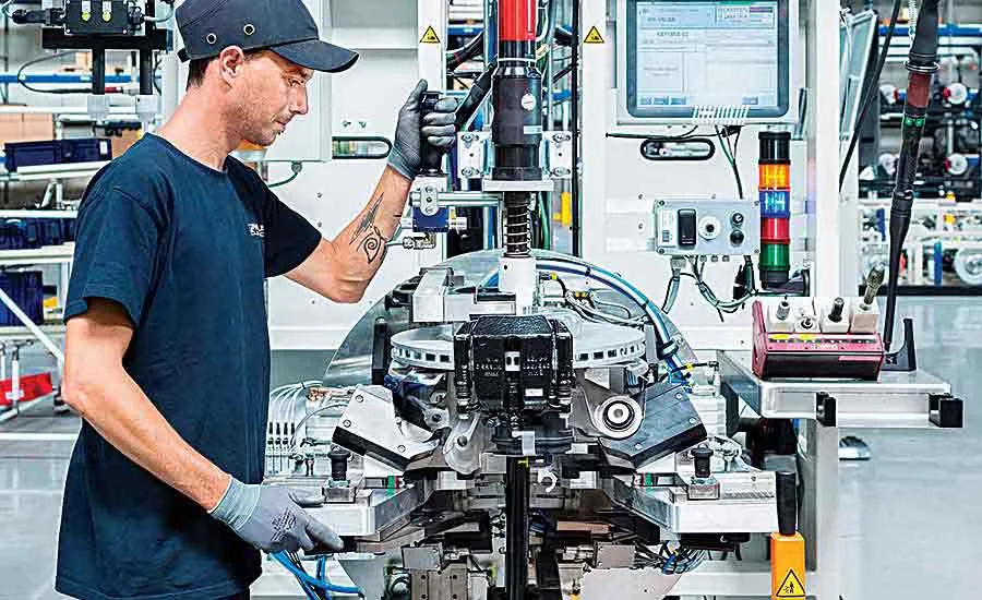

This operator oversees the pre-assembly station for swivel bearings and wheel carriers. Photo courtesy Desoutter GmbH

At the station where the struts are mounted on the pivot bearing, the required torque is applied by an EAD angle wrench that is flanged to a carbon arm and rotationally mounted. The carbon arm safely captures the reaction torque and can be easily guided with two fingers to the screw point.
At one of the pre-assembly stations, a double-screw system mounts the calipers on pivot bearings or a wheel carrier. Desoutter designed the twin screwdriver to hang from a crane so it can be easily moved in three axes. Thus, the employee is not hindered when he performs the other assembly steps.
