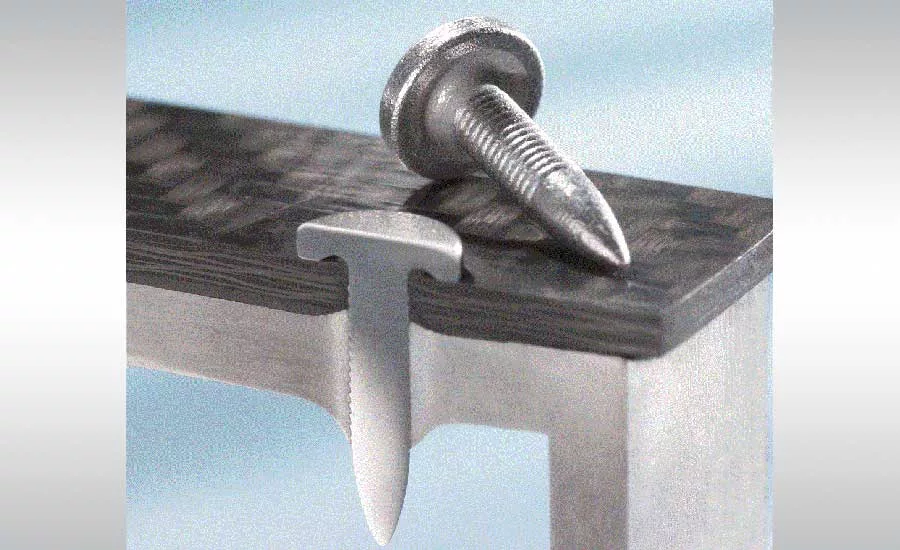

For Mercedes-Benz, the right system was one that automatically installs RIVTAC fasteners made by the Böllhoff Group. These fasteners join thin, light aluminum, steel or nonferrous metal sheets to a thicker, heavier metal surface in milliseconds—but require no prepunched hole in the top layer. Durable metal sheets and multiple layers can be joined, without any loss of material performance.
The tack fastener is made of steel that undergoes a cold heading process. Its shank is then thread-rolled, and the whole fastener is heat treated before being coated with zinc nickel for corrosion resistance. The finished fastener has a 450 HV10 rating, is 16 millimeters long and joins metal stacks that are 3 to 6 millimeters thick.
Installation system components include a vibratory bowl feeder, loading station, valve and power units, an HMI and a 90-pound installation tool mounted on a large robot (purchased separately). Before assembly begins, bulk fasteners are fed from a bowl feeder into a feeding rail on the loading station.
The tool’s setting head is then docked to the rail, where tacks are pushed from the rail into a magazine. During assembly, the nosepiece touches the metal surface and the cylinder pushes a tack out of the magazine at a speed of 20 meters per second. This velocity produces enough energy for the tack to penetrate the top and lower layers of the stack in just 6 milliseconds.
As it penetrates the stack, the tack displaces material into the threads on the shank, resulting in a form fit within the joint. When the tack reaches its final position, the cylinder raises back up to its starting position, and the cycle is repeated. Because of the high speed at which the tack joins metal stacks, it can be used with adhesives.
