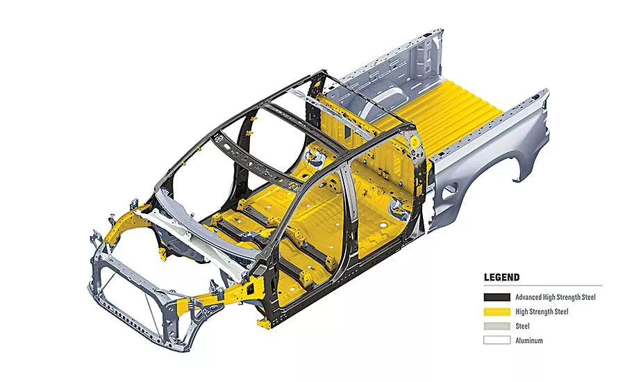

The 2019 Chevy Silverado 1500 pickup truck uses several types of lightweight materials, including aluminum and advanced high-strength steel. Illustration courtesy General Motors

TOKYO—One of the many ways to reduce the energy required for transportation is to make vehicles lighter. High-strength (HS) steels are perfect materials for this purpose, as their higher weight-to-strength ratio allows for the use of less metal to achieve a similar structural integrity. Many automobile companies believe HS steels will be essential for building cars in the future.
