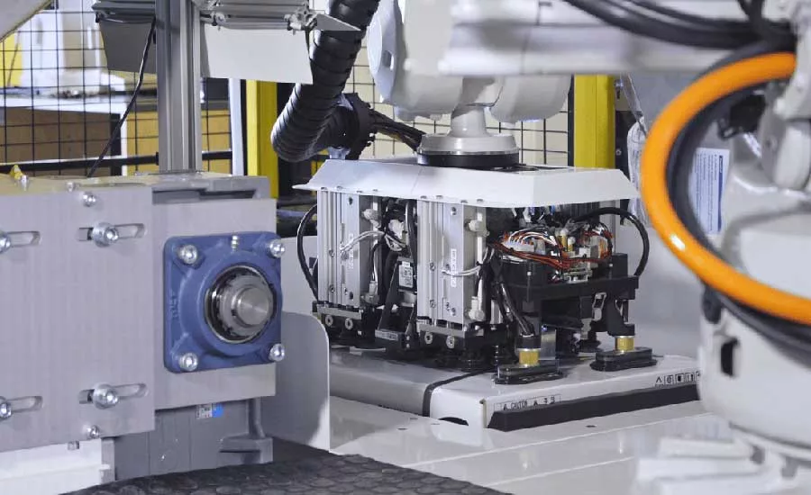

A six-axis robot equipped with a multifunction gripper automates the process of unloading boxes of battery cells from a shipping pallet at the start of the line, scanning them for traceability, removing the cells from the box, and recycling the cardboard. Photo courtesy JOT Automation Inc.

JOT provided a turnkey automated line that tackles even those tasks that fall outside standard automation equipment. The system even automates the process of unloading boxes of battery cells from a shipping pallet at the start of the line, scanning them for traceability, removing the cells from the box, and recycling the cardboard.
